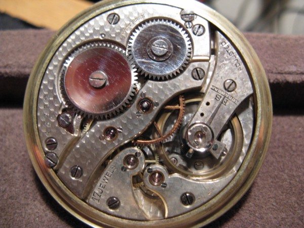

Hi all,
Can someone here tell me what make this watch is.
It has a dial marked "Elliots Special" from Medicine Hat Alberta. I think I posted this one before and it was suggested it likely was an Omega or possibly a Longines. I would like to find the regulator spring for doing the adjustments on it.
Bill

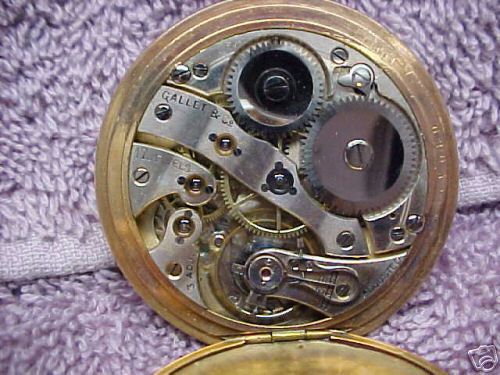

It may be a Gallet. This is a hunter version similar to yours.
Kevin

Hi Kevin,
That sure looks like the movement, slight difference in the winding wheels, but plates look the same.
Thanks for the info, now if only I can find a whip spring ?
