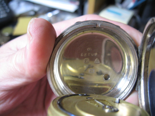

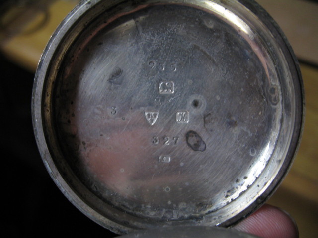

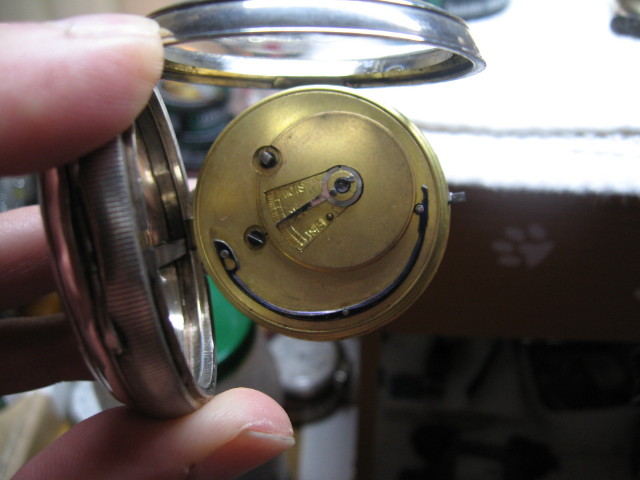

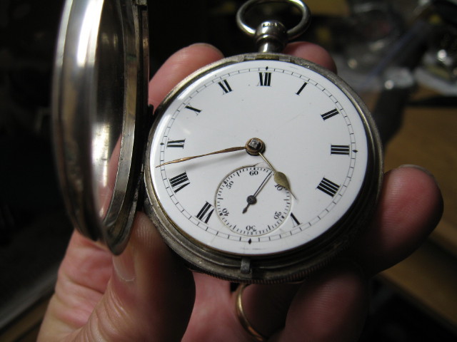

Here are some pics of my other unknown English pocket watch. Keywind and set, about 18 size, in a silver, snap bezel- swingout style case, back opens by pushing a button in the crown. Can't tell anything about movement as it has what I guess is a dust cover. Winds counter clockwise. Thoughts, opinions or conjectures welcome.

You can slide the blued spring clockwise just a bit as the oval opening on the left side allows and unlock the dust-cover. Use the pin in the middle of the spring to move it. No force ! The spring is just a lock that holds the dust cover.
Don't touch the screw! It is holding the balance cock.

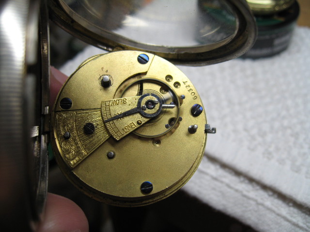

Gary E. FosterThanks Gerald, here is a movement pic. I see 2 jewels in screw down settings, plus balance jewels. Only marking is serial number.

Gerald ZimmermannThe case is hallmarked: Sterling silver, Chester, 1910 'K'.
The movement is obviously later than your other watch. The plates are screwed, it is higher jeweled and i assume it has a 'dummy fusee' that means a going barrel and a reversing wheel so it  winds counterclockwise .
