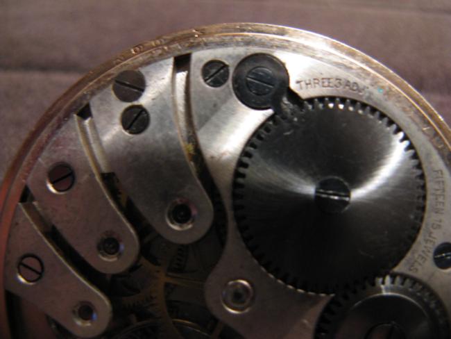

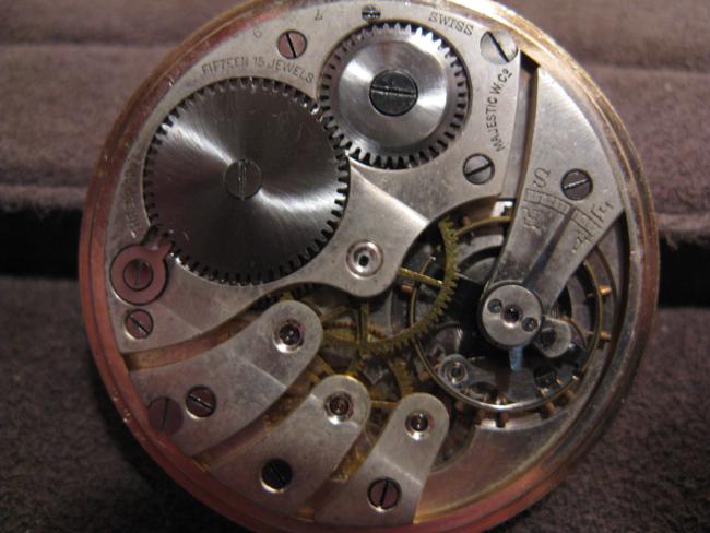

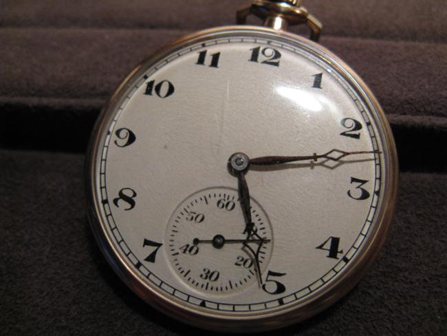

Has anyone got any information on the Majestic Watch Co. It is swiss made, it has 15j and 3 adj.
Can you advise me of the quality of the movement, possible date of manufacture, etc.
This is really a good looking, clean 12s watch. Any info would be appreciated. Thanks,
Bill

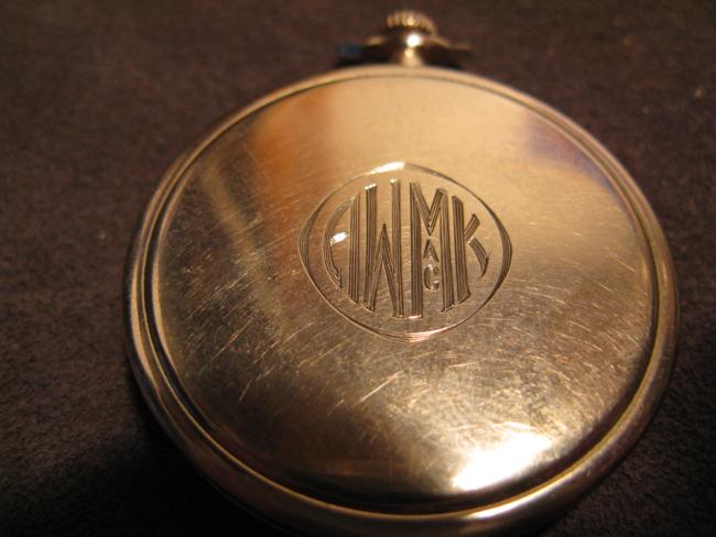

case back

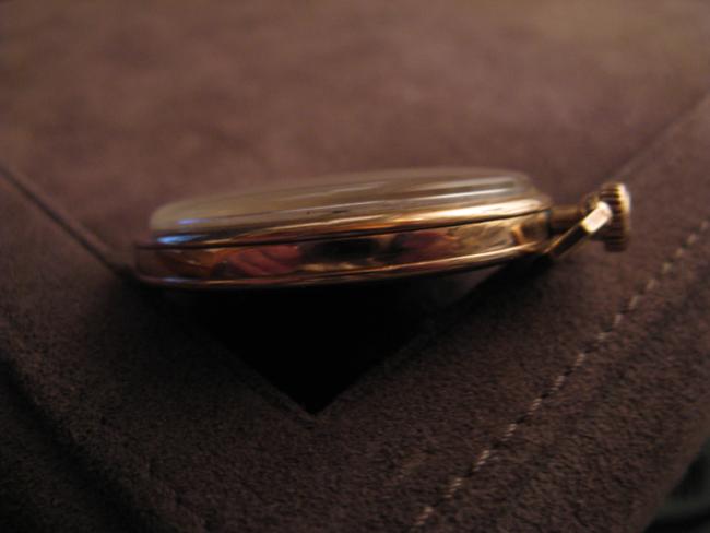

case side - this really a slim case

Bill, I put the Majestic Watch Co into Google and came up with the info that Thommen made the Majestic Watch Company movements, which were imported into the U.S by Wittnauer.
A source for the information aparrently came from "Swiss Timepiece Makers" by Kathleen Pritchard.
I've never heard of this publication before, but it sounds like a handy reference to have.
The movement itself is quite nice quality.
Well jewelled, with a cut Bi-metalic compensation balance and timing screws, plus a Breguet Overcoil Hairspring.
The hairspring stud is a small giveaway of a better movement too, as it's a triangular steel stud crimped onto the hairspring.
With 3 Adjustments too, it puts it a cut above the norm for physically similar movements.
The watch appears to be Stem Wind/Set, and the centre wheel looks like it may have a solid pinion,(no taper pin for attaching the cannon pinion), so also taking account of the case and hands style, I'd make a stab at the Art Deco era, say the 1920's.
A very nice find, thanks for posting the pic's for us (and apologies for taking a while to come back on this).
John.
