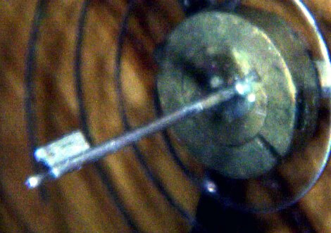

This 1st photo is of the balance staff & the verge.
verge
April 15, 2009, 22:19
Now in this photo you will see the staff passing in front of the wheel, the verge is turned towards the wheel so as the balance swings it lets the wheel turn one click.
Basically the verge & the wheel act as a pallet fork & the escape wheel in a more modern watch.
I hope this helps.
