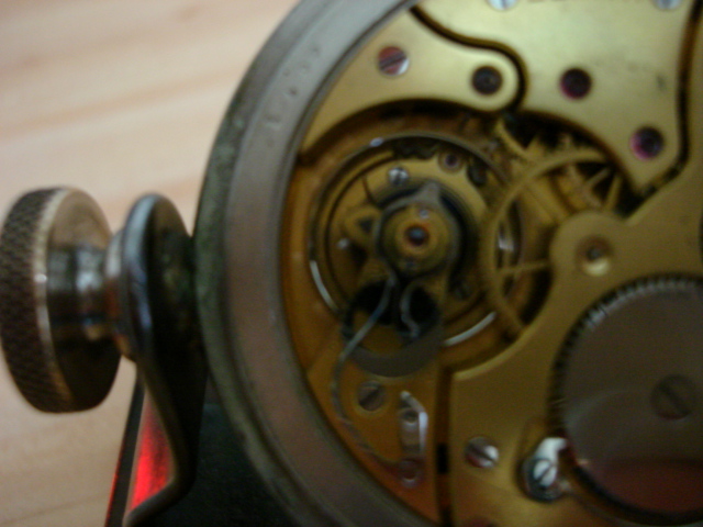

Hi everybody, this is in actual fact my first ever 'post'. After cruising your excellent site for a couple of days or so I must say this is a fantastic meeting point, at first I thought it a little 'American centric' but after reading some of the really excellent and informative posts AND learning that the European Moderator is a fellow countryman, I thought, 'must join', so here I am.
Anyhow, I wonder if anyone could give some tips on how to regulate an early Zenith. It is a little unusual ( with my limited knowledge) in as much as the winder is at the 3 O'cock postion. At first I thought it might be a cockpit clock as it is set in a small bracket on a wooden stand but it has a white enamelled face which I think knocks out the cockpit clock theory but I just love it ( that's why I bought it). Have emailed Zenith giving mvmnt details and am awaiting their response. So, if anyone can help with regulating it I would be very grateful (currently runs at +2 mins / 24 hours). I tried to attach a photo but the file is too big (did say this was my first ever post), but if any needed to 'fill in the gaps' pls advise and I'll take some more and try to attach

February 15, 2008, 08:12
Terry Pitt
1 of 3
TJP
February 15, 2008, 08:13
Terry Pitt
2 of 3
TJP
February 15, 2008, 08:14
Terry Pitt
3 of 3

Thanks for posting photo's of this unusual clock too.
I wouldn't hazard a guess as to whether it was originally created this way, or a later conversion.
Maybe Greg or someone in the Military forum could comment if they've ever seen anything like it.
The movement appears to be originally intended for a 'Hunter' type case, which would have had a catch released by pressing the crown to open the front cover.
The dial appears to be in excellent condition too, and free of stress cracks / hairlines which is nice.
The numerals would have originally been filled with luminescent compound inside the outer frames, and also inside the framework of the 'Cathedral' style hands.
As for regulation, to be honest, I wouldn't mess with this until it's been cleaned at least and the mainspring checked, otherwise you may just be attempting to adjust out the consequences of dry and dirty jewels and a weak mainspring etc.

Thanks for your thoughts, I'll take your advice and get it cleaned as the first step. With regard to the face, you are right because at night or in low light there is the faintest 'glow' from the numerals (yellowish/green. the hands are skeleton type and I think they are pink gold
The movement No is 2050375 FYI, will let you know what Zenith say in their reply

A rather nice old Zenith. One way to check if the case is factory or not is to see if the serial number of the case matches the number on the movement.
The swivel case is what I would expect for use in a vehicle, such as an automobile. Although, I have seen other cases -like yours- set up as desk clocks. Your watch/clock does not appear to be military issue, though clearly a high quality item.

Thanks for your thoughts, have checked to case.
No 4971 occurs on the case back and the case itself so I guess case and movement came together at some time later.
Looks like John is right with the hunter theory, would've been some watch I think as it's a full 58mm (approx 2 5/16th inches) diameter excluding crown. Anyhow I just love it and that's the most important thing to me, but very pleased to hear you consider it of good quality. Will get it cleaned and checked as John advises.
