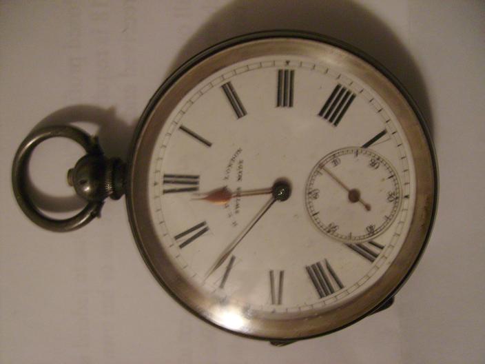

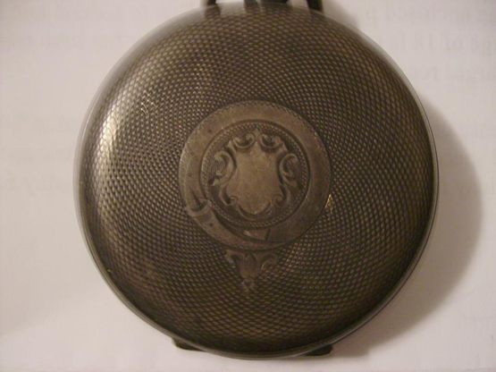

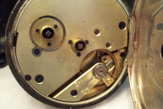

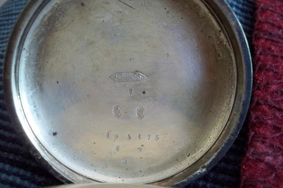

Hi there,
I am new to this forum, and would really like some help. My Mum recently inherited a silver pocket watch from her aunt & we would love to know more about it. I would really appreciate any information that you could give me.
Thank you in advance,
Naomi

About the only thing I can tell you is your watch case has the Swiss sterling silver hallmark of a standing bear facing left, this was used between 1882-1935.

Your Mum has inherited a typical but Very nice 'Swiss Cylinder' type Ladies fob watch typical of the late 19th and early 20th Century.
H.E.Peck would have been the retailer of the watch, and had the enamel (porcelaine) dial specially fired with his name on it.
Peck would Not have made the watch or case.
I still have quite a collection of these watches, even though I've disposed of many of them.
If you check the other topics in this forum, you will also find one for the decorative dials.
(sorry, can't find the link without going off the page as I'm on dial-up at the moment - takes an age for pages to load.)
A few points about the watch too, it is in beautiful condition and quite unworn, just needs a good clean, and the central cartouche being clear of engraving is a real plus!
The hands are incorrect though and replacements.
Too long on both the hour and minute, and would more likely have had a matched pair of 'Spade and Poker style, rather than the 'Poker and Diamond' as fitted.
There should be a dust cover located around the hands setting square on the centre of the movement - you can see the holes where the screws went!
I could probably help you out with correct hands and a dust cover as I've quite a lot of parts for these.
However you may be quite happy to keep the watch as it was passed on to you!
Tom was spot on with the hallmarks! (Thanks Tom)!
As an aside, Sterling silver is .925 but cases are very often marked .935 which has a tad more silver content.
