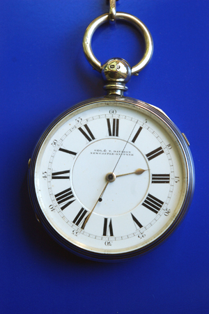

I have a large (2.5+ inches in diameter) open face pocket watch, key wound and set, with a “sweep” second hand. The hallmarks indicate that it is sterling silver with a date of 1877. On the movement it says “Geo. & T. Davison, East side of Grey Street, Newcastle-upon Tyne, Makers to the Admiralty.” Can anyone tell me anything about this maker and this type of watch? Thank you.

The style of this watch is often referred to as a 'Doctor's watch' because of the sweep seconds hand, which can be stopped by the sliding button on the side of the case.
Rub is though, stopping the seconds on these also stops the watch, because the slider activates a wire pin which then rubs the roller on the balance.

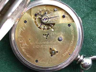

Donald BakerThis forum is great, as you know. I posted on 2 other forums and got zero information, and here I have useful data already. I have attached a photo of the movement. John--an interesting point about the sliding button on the side of the watch--this one doesn't slide, and there is no place for it to slide. Does this imply that it was made to resemble a better quality watch? Thanks again to all for the replies.

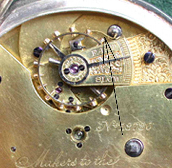

John WoolseyDonald, the button on the band is far bigger than the hole it slides in.
At the back of it will be a small thin tab with a wire attached.
Even with the button moved in its extremes, the hole will not be visible.
Chances are it's either stuck or been jammed.
Looking at the area near the balance rim, there's what looks like a wire, my guess is it's the stop wire actuator, and doesn't look to be fitted properly or connected.
There should be some sort of a crank lever there, but not always clearly visible.
I've enlarged and cropped your photo, and stuck a pointer on it to the wire in question.
Not a problem if it's been jammed out of the way, as long as it can't fall into the escapement and lock up the watch.
Always nicer when bits that are there work though.
It could just be jammed with corrosion and grot if the stop's not been used for half a century or so!
BTW, it's almost certainly an English Lever type escapement.
Look for pointed teeth on the escape wheel, if so it's English, if club toothed on the tips, it will be a Swiss modded job but very unlikely.
