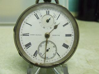

I got this yesterday, I know the maker as clearly shown. John Hando of Brecon, the case is silver, the watch is not working at the moment, I will endevour to take it out of the case to have a better look later. If some one can give me more information about the type and maker and age. Then i will be happy. Thanks Francis. I was given this watch, nice blessing.

Francis Bowmanthanks Tom, yes it is a nice watch. but silly me bent the hour hand. A very good lesson learnt here. The dial with up 0-6-12-24-30 what is that about doesn any one know? yes there is a pin holding the watch at the case, once my son goes to sleep I will take it apart i can not see any chain and the hairspring doesnt move. i have another movement to put into it but not sure of all is the same size, tomorrow is another day i guess.
October 23, 2010, 01:35
Tom BrownI thought that dial might be a wind indicator but I can't tell for sure from your photos.
What little I know of European watches, I don't believe it is a fusee movement, I do not see a indication of a fusee.
If I was you I would consider having the watch repaired, it looks like a nice watch & if that is a wind indicator I would think a more valuable watch than the run of the mill.

Tom BruntonHi Francis and Tom ; Tom is right on , it is clearly a wind indicator when blown up on my iMac. That is an unusual and quite desirable English movement and the very last thing I would do is put another movement in it. It will be a beauty when it is fixed up,in my opinion

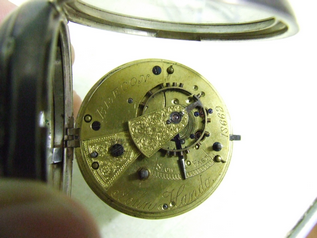

Francis BowmanHello Tom and Tom, well i have checked out a few things on this little baby. Yes Tom the case is the same Serial number as the movement, I did get the hinge pin out and cleaned the case to see how badly it was under all that grim. The Glass needs to be replaced, the balace cock is completely gone and the two pins are bent.the hairspring has no holding pin,I have a whole tin of those suckers. The case come up very beautiful. Wind Indicator interesting name why did they call them that If u dont mind elaborating for me. I can not get bigger photos up on here tom I can send u some larger ones if u like let me know and I will take some.

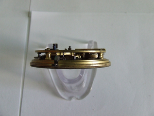

Francis Bowmanwhy i said it was a fusee was the chain drive off the main spring. I will take a photo of the drive if I can get in a clear shot of it. Francis.

Tom BruntonHi Francis;It involves the dual meanings of the word wind. It can mean the wind is blowing,or don't forget to wind up the alarm clock !!!
In the watch ,it indicates how much running time is left on the mainspring. At 30 it means it is fully wound up,and will run for 30 more hours,at 6 it is almost fully unwound. You could at a glance see whether your watch needed winding. As to the chain,if it has one on a tapered pulley,then it is a Fusee

Francis Bowman@Tom Brunton, it is driven by chain, most of the experince i have is with normal Pw this is so beautiful such craftmanship.Now just any balance cock can not do I imagine. Do u look around for the same maker and size, I have one simular but very much doubt that it would fit or work. Can miracles happen? we will we. thank u Tom and Tom.

Tom Bruntonhi Francis; I think we have a problem of word meanings here,differences between the Aussie dialect and the American and Canadian.. We call the balance bridge the "Balance cock" and it is clearly present on the watch!!!
I suspected as much the other day and hoped the photos would show the problem
We'll get there Francis,with a little time and patience with each other

Francis BowmanOk tar and feather me gents it is the fork that is missing not the cock. Seem to have the word firmly stuck in my brain the last few days. Cant blame the lingo as I learnt from the Chicago School of Watch Making Series, some could say "learnt wat" lol....ok photos are on there way.

Francis Bowmani dont know if u can clearly see in these photos as I have had to reduce them so much.
