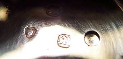

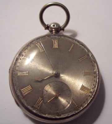

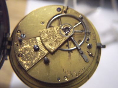

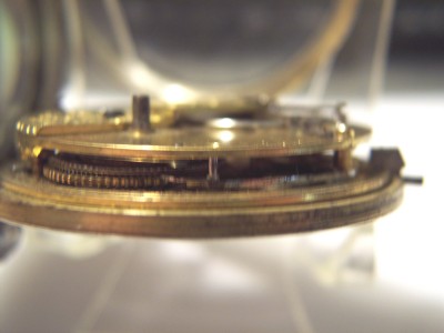

May 30, 2006, 21:06
Tom Huber
Hi Sheila, I know why you like them. They are unique timepieces, albeit a little expensive to have repaired if a part is broken. I looked at the London Hallmark list, and to my bet guess, the hallmark date is 1867. Yours is a fusee. Is it running? On the side view of the movement, it looks like the fusee chain is loose--unattached.
May 30, 2006, 22:04
Sheila Gilbert
Tom,
I don't think this one is a Fusee, what your looking at are two wheels.
I'll post another picture later.
It's a lot like the last one I posted here:
https://ihc185.infopop.cc/eve/forums/a/tpc/f/2291010082/m/3221064481
Your right about them being unique. Thanks for the date, saves me from looking it up.
As far as it working, it wants to, but I'm a little worried about winding it, because when I tried, I felt pressure, so I stopped.
The seconds does move when I turn the balance wheel, and the balance wheel moves freely.
I still can't tell the difference between the fussee and the ones that just look like it!!!
Sheila
May 30, 2006, 23:11
John Pavlik
Sheila,
This is an English fusee.. How to tell by the movement, check the winding arbor, it will always be located in this position..realitive to the balance cock..your other one is located to the "north" of the balance cock..the wheel you refer to is the fusee cone, where the fusee chain winds around, the upper steel tooth set is for the maintaining power click to engage in..

May 31, 2006, 20:17
Sam Williamson
Sheila, since this is an English fusee, try winding COUNTERCLOCKWISE to see if it runs.
