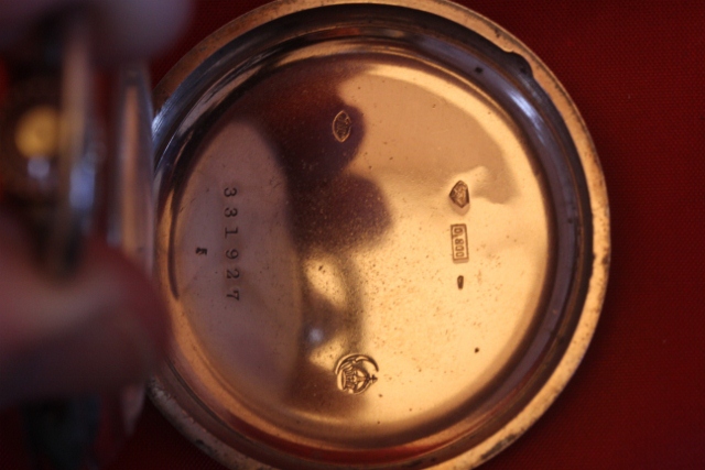

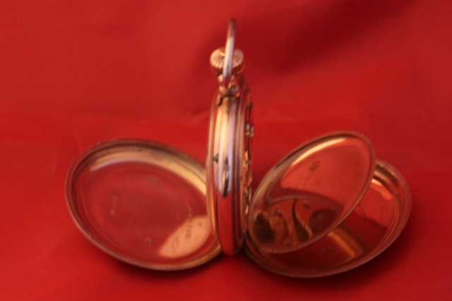

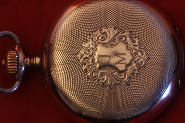

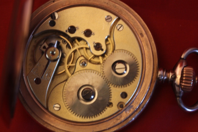

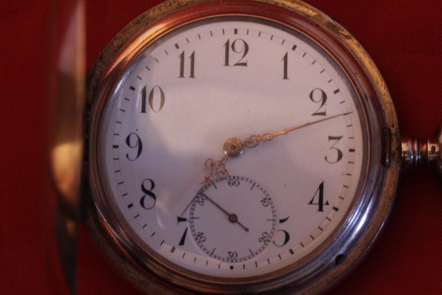

David FlegelYour opinions please on this watch.
I bought this a number of years ago and it is probably a complete disaster when it comes to quality. Opinions please I am donning my boy are you wrong on this one bullet proof vest.

Nothing wrong with this one (ok one case screw)!
19 lignes IWC 56 movement, lever set, 15 jewels. made ca 1905. (serial# ?)
Case .800 silver marked swiss and german, almost no wear on the red gilded rims. Dial,hands pendant ok no wear on the crown, runs.
Fine watch to wear.

Ethan LipsigI haven't a clue as to who made the watch, but it looks to be of reasonable quality and in very good shape.
The case puzzles me, however. There appears to be an ".800" stamp on the inside cover, denoting coin silver, but the case appears yellow in color. The bow appears silver in color. Is the case all yellow except for a silver section on the back and the bow? Is the yellow metal silver-gilt (i.e., vermeil), ygf, or solid gold?

Evan PattonBeautiful case! I can see why it grabbed your eye. I noticed the stamp and case color as well, and am waiting for someone with a clue to educate me.

David FlegelNever really thought about it, looks as if the back and front fit into the rest of the case the way a crystal would fit into a bezel. The outer colour might be a gold wash.

Gerald ZimmermannOn the case questions:
The case is 80% silver (coin). It was fashion at this time to accentuate the rims, the bezel and the pendant with red gold electroplating (it was made better than on todays gilted cases, it is probably more like a 15 year plate, but it will wear through).
If those cases are worn, one can polish them to the silver. This one is in very good condition

Ethan LipsigIs the watch missing its ratchet?

Francesco Marco MaraschinA very nice watch.
Gerald, how Could you tell that it is a iwc movement ?

Gerald ZimmermannFrancesco
'I know my birds by their feathers' endjoke
There are not so many swiss pocket watches with lever set and my first guess was spot on.
compare:
Ranfft Ethan: The ratchet/click is hidden on this calibre. you can only see a small tooth engaging.
