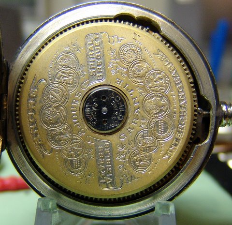

Can anyone explain how to remove the mainspring barrel from this Hebdomas style 8 day pocket watch.
Thanks
rear
April 20, 2009, 11:39

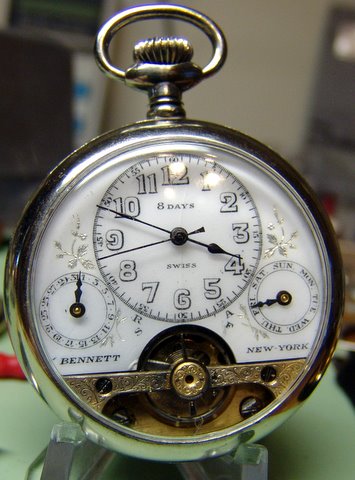

This is the dial side.
dial
April 20, 2009, 16:21
Gerald Zimmermann
First let down the mainspring. Click is slightly visible at top of your photo. Be careful this spring is loooong. The steel disc in the middle is a nut. If should unscrew counterclockwise.(not quite sure about the direction) You need a pair of stable tweezers or round pointet pliers fiting the two holes. During the unscrewing you shoud fix the barrel with your thumb not leting the force effect the click or a tooth of the barrel. After unscewed lift the barrel with care. There may be still a little energy on the spring. If you have to remove the spring be sure there is enough place on your bench or do this on a table. If never worked with this you can hardly imagine the dimension if the unwound spring.

Thanks Gerald
I have never worked on one before but thought I would give it a try, I do have another mainspring & I see what you mean about the length. I guess to run for 8 days it need s to be that way.
The only time I did one longer was a victrola that had two mainsprings about 30' long, they were fun to unpack & clean, then repack without cutting off any body parts.
