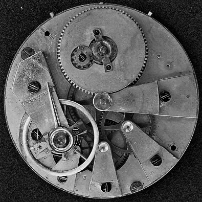

I have senn this PW on ebay, and I couldn't resist: the movement looked so nice & clean, and I bought it. I ahve received it right this morning, and it is a nice, large sized (almost a 16s) silver 800 PW, in (almost) working conditions. The silver hallmark is Minerva head for silver .800, so it has been made after 1836, it's a Swiss bar movement remembering a bit of Breguet style, cylinder escape. Could you kindly give me some more information about ? The anglage is not bad, but I do not think it has been made manually, so I would place it after 1880 or so.

Hi Mario
nice,no junk !
A Lepine IV movement(2 bend bridges), made in france, clean, very flat - i like it !
Lepine IV were made 1835 - 1860 (main period) some(mostly smaler sizes until the turn of the century).With no mark on the movement and an unknown case maker it is hard to give a date.
Your example shows more resemblance to Lepine III (minute wheel hold by a finger) then to Lepine V (since 1850, straight barrel bridge). The fingers have a triangular shape, not the straight and later form).With no further information like the dial, the dust cover or the case I would date the watch 1850 - 1860. The anglage looks hand made but not perfect. Unusual shape of the minute wheel bridge.

Mario, I agree with Gerald....it certainly is not junk...!
I'm impressed with how clean the movement is and the straight lines it has and I have always been amazed by the early swiss or french watches....more so than the newer ones....

Mario,
Nice clean looking LePine movement!
The best way to determine just how far the 'handmaking' of the movement went, is to take off the dial and check the pivot holes for scribe marks.
These scribed 'arcs' will have been made by a depthing tool used by the watchmaker when planting the gear train.
Much of everything else will have been machine made or finished from castings.
A particular feature of this type LePine, is they are Very thin movements.
My guess (hard to determine from the photo's) is that the movement from dial plate to highest gear cock will be under 3mm.
It's likely that the watch as a whole will be exceptionally thin!
Not seen too many of these movements actually still in their cases, Nice Find!

John, you area absolutely right, depth is just 3.8 mm, while diameter is 42.7 mm. In any case, I have added a picture of the base plate side under the dial on at the address Parrod PW so that you can have a look to.

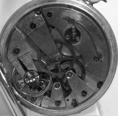

The Lepine movements are sometimes classified in 'types' Lepine I .... Lepine V (roman numerals). I did not find a english source about this so I will try to get some pictures and will post them later.
first a short listing of the (main) time periods they were used:
Lepine I 1800 - 1825
Lepine II 1825 - 1835
Lepine III 1830 - 1840
Lepine IV 1835 - 1850
Lepine V since 1850 key wind
Lepine V since 1870 stem wind

Lepine I 'Lepine'
'flying' mainspring barrel hold by the dial plate
all other wheels held by separate fingers with radial orientation.

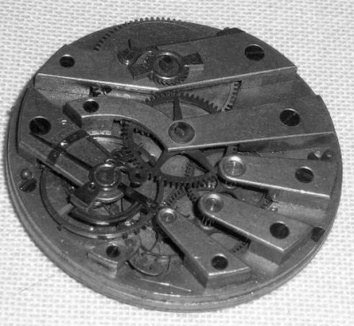

Lepine II 'demi-Breguet' (half-Breguet)
Quarter plate for the mainspring barrel
Minute wheel still hold by finger

Lepine III
Mainspring barrel hold by a bend bridge

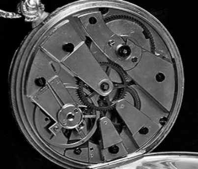

Lepine IV
Minute wheel too under a bridge

Lepine V
Mainspring bridge straight
the bridges and fingers have lost the triangular shape and are parallel.
