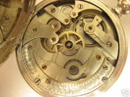

This "Gladstone" watch is missing the Winged Hourglass on thne balance cock, but looks like a near perfect "reversed" "Private Labelled" Longines L20B. (Extra bridge for the escapement wheel on this chap.)
I need an expert opinion. Please comment

It looks like the "flip side" of my Longines L20 excepting the Escapment bridging.
November 06, 2007, 18:24
Stephan Gaal
I see a few more differences than just that. There is the key guard with 2 screws that the Longines does not have. On the Longines the main spring ratchet wheel breaks out on the side of the bridge casting but on the other it does not. On the Longines there is only 1 main bridge but the other appears to have a seperate one for the 3rd and 4th wheel. Something else must be different to make the space to fit that extra bridge in.

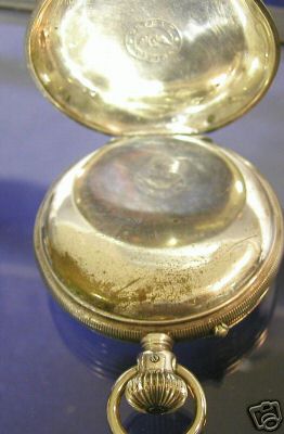

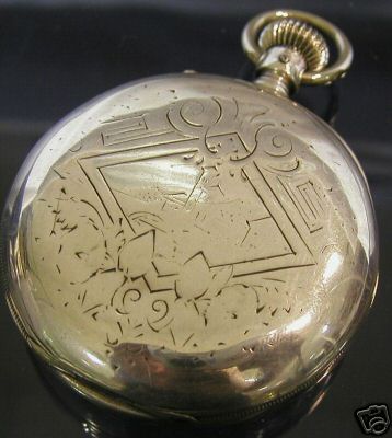

Ray Thank You very much, I will do that. Also I am adding another signed Longines with the same type "extra bridge" movement that I have and it is beautiful. I love these watches.
November 07, 2007, 17:25

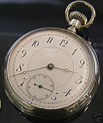

I hesitated to add this earlier because it is a smaller size movement, buit the plate designs are much more like the "Gladstone", than my "Arizona" Longines is which is a L20B.
The signed case is a beauty on this one too.

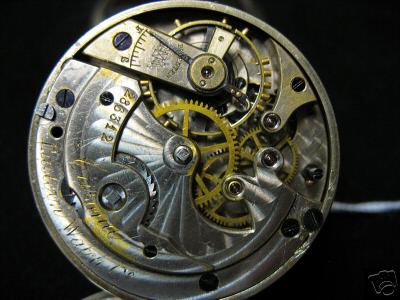

I have 2 18 size private label Longines L20 watches. The open faced one 284214 is marked Aurora Ill and the hunter cased version 261618 is marked Eastern Watch Co. Neither mentions the name Longines but both have the winged hourglass on the balance cock.

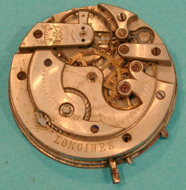

David, This is from my junk box and appears to be an exact mirror of your smaller Longines save the different plate material.
