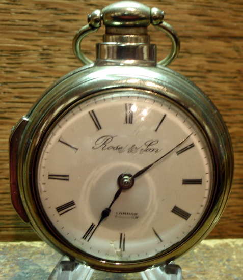

Just finished another early English fusee watch, this one is marked on the dial & movement Rose & Son London.
Looking in Loomes 21 ed. it shows Rose & Son of London in the mid 1750's & that they reported a lost watch in 1786.
The case unfortunately is not hallmarked, it isn't sterling silver, it feels more like nickel or some other metal, doesn't appear to be plated.
The watch doesn't have a serial number showing on the movement but each part is stamped with the number 2.
The watch keeps good time for this type of watch.

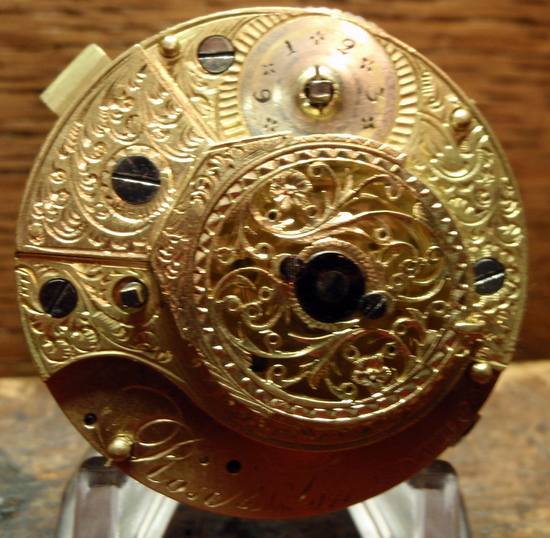

The case is a pair case.
The movement is highly decorated.

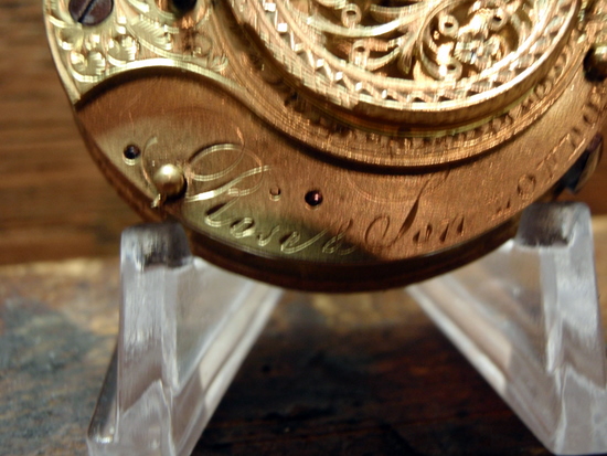

This is another view of the Rose & Son London

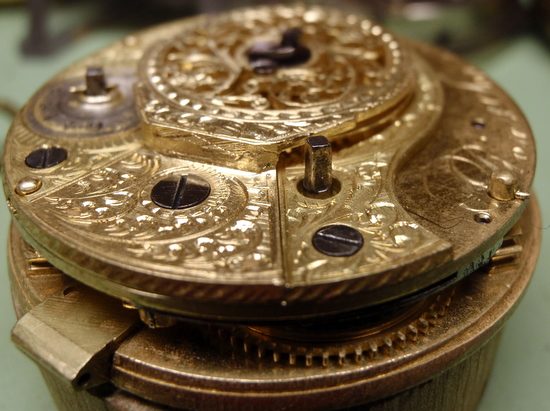

Another view of the engraving.

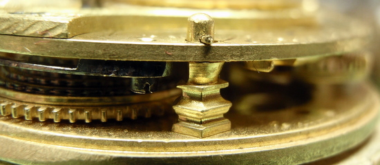

This photo is of the square shaped pillars.

Tom, I collect railroad watches but am fascinated with fusees. I wonder if your case is pewter or Britannia metal? Years ago I had a Swiss movement that had, to my surprise, a platinum movement. The 80 year old watchmaker who told me that sure got my attention! The reason I mention platinum is that the Russian Imperial government made platinum rubles for circulation and some Spanish counterfeiters used platinum to make fake gold coins. They did not realize it had value by itself. Also nickel did not come into use in coinage until I believe the 1850's. I don't think it was a refined metal until the 19th century.

Yeah, I don't really know what the case is made of, when I said nickel I wasn't too sure that was around at the time, doesn't have the weight of a silver case & no hallmarks so I don't really know what it is. There doesn't seem to be any wear through to another material so I would guess it is solid something.

If it's a pure metal you could calculate it's density and then look it up in a table.
To find the density measure the weight (mass) of the outer case then place it in a measuring cylinder partly filled with water. Measure the displacement (volume) then divide the mass by the volume.
Most science books have density tables but, failing that, you could look it up on the Net.
Pure silver has a density of approx 10.5 gm/cm3 but this could be anything up to 12gm/cm3 depending on the quantity of alloy used.
Of course, this won't work if it's an alloy of base metals but it's worth a try. Also, don't forget that many English sterling silver cases never got hallmarked simply to avoid paying duty.

The regulator is a 'Tompion' type, generally made from Sterling Silver, and the square pillars are called 'Egyptian' style.
The balance endstone is a nice unusual touch too!
