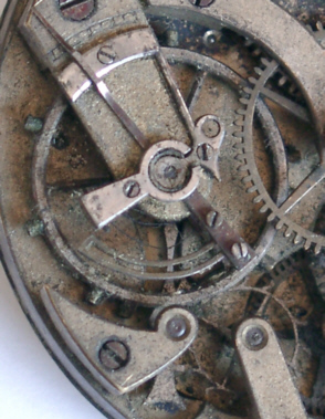

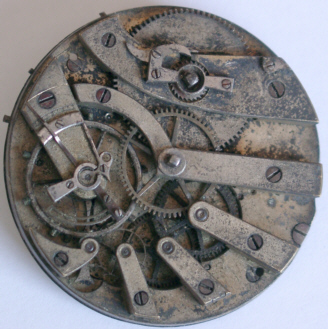

This movement came from my junk box. To me it looks like something a bit better and I was hoping somebody can tell me about it. It has 15 jewels I can see. The regulator assy appears fairly complex and is unlike anything I can find in my books. There appears to be some kind of a quadrant that is attached to the end of the regulator arm. The other end of the quadrent under the arm has the slot for the hair spring. looks to be a solid balance with no splits.

Stephan GaalHere is a close up of the escape area. Note the extra bit attached to the top of the balance bridge. The regulator arm is shaped to lie flat on the bridge and has a slot to clear this extra part. There appears to be no reason for this arrangement apart from decoration.

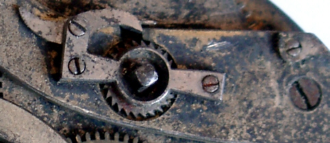

Stephan GaalEven the mainspring ratchet is more complex than needs be. There was a long flat spring that acted on it. The remains of the spring are still there. A tiny ear is provided for the spring to contact with. The ratchet wheel is set below the plate and there is an extension to the ratchet lever underneath to connect with the teeth.

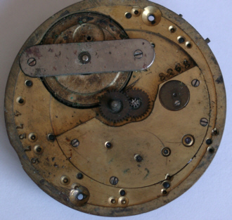

Stephan GaalThe main plate is actually made from 3 parts. with a number of screws holding everything together. 2 of the plates carry number but they do not match. The main or outer plate is numbered 47375 and is about 45mm Dia. The second or inner plate is about 36mm dia and carries a number of 8268. The third bit has the jewels and does not appear to be marked.
Is this movement worthy of restoration or should I return it from whence it came.

Jerry TreimanThe unusual apparatus supporting the upper balance jewel is called a "parachute" and is an early form of shock resist. It was invented by Breguet. You will also note the double arc of metal extending out from the end of the regulator where the regulator pins are. This is a compensation curb that changes the distance between the regulator pins with changes in temperature -- a form of temperature compensation. I have seen both of these features on a number of mid-grade Swiss bar movements. Unless you really want a project it is probably just as well to leave this as a study piece in your collection. Without a famous name attributed to this movement it is probably not worth much, even if restored.

To add to Jerry's excellent explanation of your watch, Breguet's parachute mechanism (actually called Pare-Chute), was invented around 1800 and therefore pre-dates the incabloc type systems we know by nearly One and a Half Centuries!

It appears to have a mono-metallic balance with timing screws, a counterpoised sidelever escapement (probably with jewel slips in the pallet faces), which together with the temperature compensation gear, jewelling and parachute shock resist system, would have lifted it into a completely different league to some of the stuff available in its era.
I can't see the underside of the mainspring barrel too well, but it appears it may also have Geneva stopwork fitted.
The additional bar (looks hand made to me)providing a lower bearing for the mainspring barrel is also a feature missed off many 19C pocket watches - particularly cylinder watches, and they were all the worse for it!
If you look closer at the plates of the movement, you will find it was actually hand crafted not jig drilled - note the scribe marks made by the depthing tool which marked the jewel hole centres - no fancy machines used there - that's a human touch created by someone physically placing those train wheels in a calliper in order to set out 'by hand' all those jewel and pivot hole centres prior to them being drilled!!
