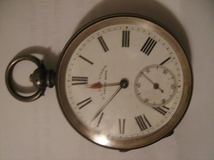

Hello
I am new to your site and also to pocket watches. Received some watches from my mother in law. One is marked H.E. Peck London Swiss Movement. It has two key slots. As I understand. One is for winding, the other for adjusting the hands. I am assuming that this is a common watch but would appreciate any information on age and any other information on this someone might have.
Bruce.

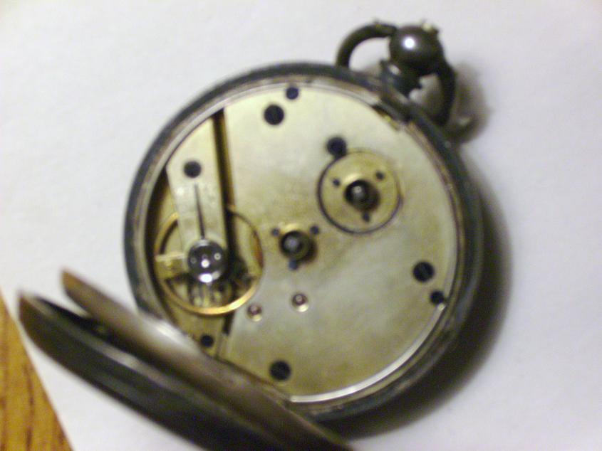

Bruce CunhaHere is the movement -Sorry for blurriness. No markings on the movement

John WoolseyBruce, H.E.Peck was a retailer of watches, so it's possible yours was originally a UK import.
If you can check for hallmarks on the case domes, and post a photo, it'd helps us provide more info as to whether it was a UK import of a Swiss watch, or an imported Swiss cylinder movement cased up in the UK by an English casemaker.
I'd guess the age of it to be around 1880 or so, give or take a decade either way, but any hallmarks would help.

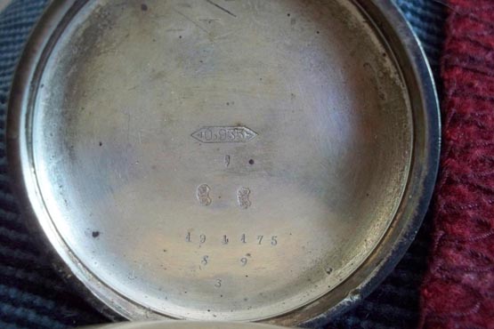

Here is a picture of the inside of the case. Appears to be two standing lions. Face of the watch does say Swiss Made.

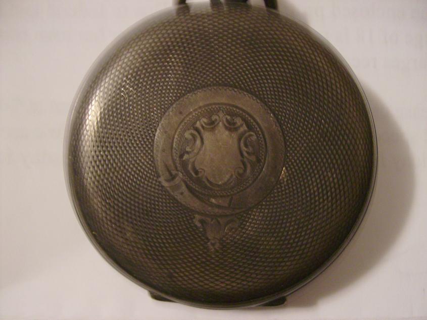

The case is very dark. Any thoughts on what the finish is?

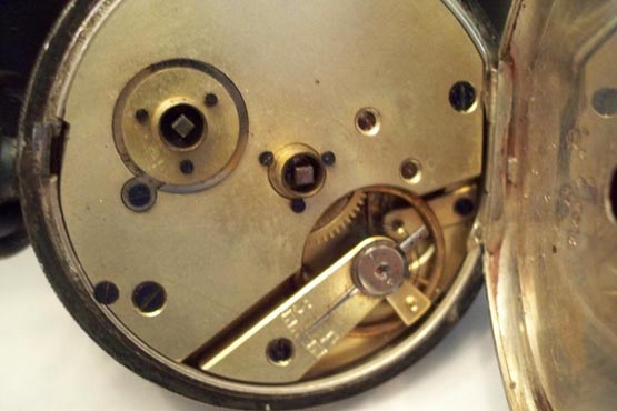

Bruce CunhaHere is a better picture of the movement. Very plane and without markings.

John WoolseyGood photo's of the hallamrks and movement Bruce, thanks for putting them up for us.
They're Swiss hallamarks, the two standing bears are also copied in the smaller shield just under the 0.935 grade mark.
0.925 is Sterling Silver, but 0.935 is a common grade used on imports.
Which also answers another question, the case is solid silver, so a good silver dip cleaner plus a careful polish will bring it up a treat.
Take the movement out first though!
The movement is a Swiss Cylinder type.
These commonly stop running usually when fully wound.
It will have a blued steel mainspring fitted - unless someone's changed it for a later alloy type, and which gets weak and 'set'. When fully wound, doesn't have enough grunt to get the train transmitting enough power to impulse the balance.
You may find it will tick for a few seconds if rocked gently to get the balance moveing.
Not too hard though, if you hear a 'pinging' noise, back off, it's the banking pin on the balance rim hitting the stop under the balance cock. (you can just see the pin on the bottom of the balance near the case edge).
This prevents the edges of the cylinder hitting the back of the escape wheel teeth and busting stuff.

Bruce CunhaMost appreciate the response John. Tried the rocking movement but do not see or hear any action in the mechanism. Should know in a week or so if this watch is usable.
