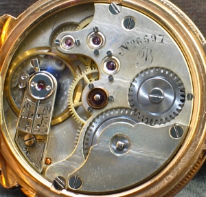

Hello all,
I bought this watch off Buster Beck (one of us, and thanks again Buster) and am having it restored to its original condition.
I have two questions that might be answered here, because although it´s an IWC, it was cased in America.
The movement was shipped to the States as was the "normal" thing to do to save on import duties.
My casemaker (goldsmith)/ Watchmaker has taken the case apart and sends me the questions, was the bow originally fastened by the splint (that was in there), or as he suggests, with a screw, as the first picture shows, and what type of crystal would have been used originally on the watch?
Here are a few pictures of the work that is being done, the case has been sent away for a subtle restoration, as has the bridge, where the case screw was so violently molested, leaving deep indentures on the bridge. There will be more pictures to follow, as the restoration gradually advances.

William D. WhiteHello Werner,
The pin was used to hold the pusher in place and the bow held the pin centered within the pendant. The bow itself was held in place via the conical ends. Swiss cases of this era used a screw whereas American cases generally did not.
The original crystal would have been a thin hunting glass.
Nice watch.
William

Buster BeckFabulous job on the restoration !!
That subseconds dial should really set it off and make it truly a unique item !!
Thanks for showing the finished product !!
