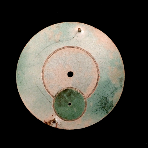

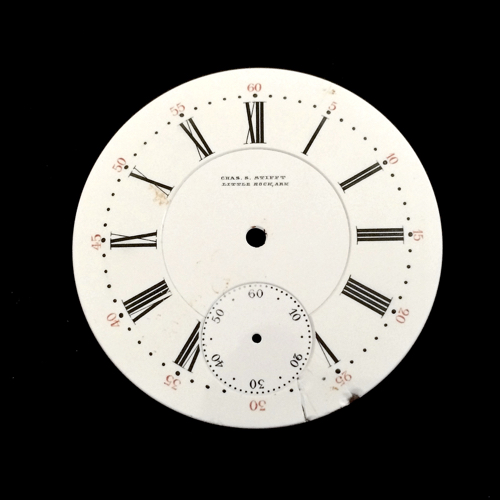

I'm hoping to find a movement that my private label dial would fit. (Photos follow.) The dial has two feet, so I am assuming it is Swiss. The feet are at about 27 minutes and 58 minutes. Any suggestions much appreciated.

Here is the back of the dial.

John, if I read the dial correctly as Chas. S. Stifft Little Rock, Ark. I have read of a couple 18s 21j Longines with that marking.
January 09, 2017, 11:58
John Watkins
Many thanks, Lorne. You read it correctly, and I failed to mention that it is an 18s dial.
