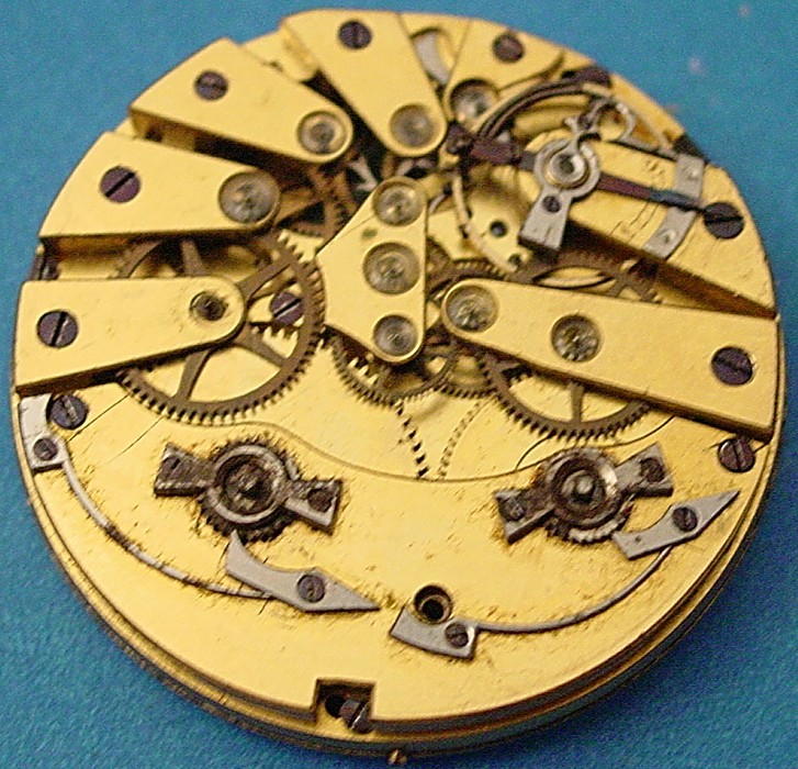

Here is a movement I found in some stuff I picked up and was wondering if anyone recognized the maker. Also why would it have two mainsprings am I missing something it looks to have a large center seconds hand and it does not appear to be a chronograph. It does have the stop lever on the side for stopping the forth wheel. Measures 45mm across. The second winding barrel looks larger like it might be an alarm but I see no other sign of an alarm. Any ideas

Stephan GaalHuguenin made some watches with a second train that operated a sweep second hand. It was not connected to the main time keeping part of the watch which had it's own spring and train but was activated by it. The sweep second hand could be turned on or off. Since it had its own spring it did not upset timekeeping when you activated it.
I am not sure what it could be used for as it had no reset on it. Just on and off. Could this be another version of this arrangement from another maker?

Robert V. JonesThanks for info maybe like the older style doctors watch so one could check pulse. Looking at the movement it is hard to tell but I did not see what I thought was a seperate train. But then again I am no expert

John WoolseyAnother very interesting watch Rob, no idea where you keep on finding these gems!
I recon Stephan has nailed the function of the double barrel arrangement, but I'd like to toss some further thoughts into the pot to ruminate on!
As far as I can recall, some pocket watch movements I've seen with a sweep seconds feature have had extra bridges on top of the main train to accommodate the extra wheel and it's pinion - which generally makes for quite a deep movement.
Your example appears to be quite slim, hence the need for the extra barrel and train wheels.
Because the train wheels are smaller, the torque transmitted from the mainspring and barrel through those wheels will be smaller, and one mainspring and barrel that size simply would not have enough grunt to move all that metal.
Splitting the trains and placing a second mainspring barrel in there to drive the sweep seconds feature would remove a significant amount of load from the main train barrel, enabling the size to be kept sensible.
A smaller barrel for the sweep seconds would be quite adequate, because there is less train to move.
I suppose if the smaller barrel wasn't re-wound occasionally, it would just mean a stationary sweep seconds hand.
I don't know if anyone has noticed it, but your watch movement is also fitted with Breguet's parachute shock protection system, and and the early form of temperature compensation described by Jerry Treiman on Stephan's watch!
