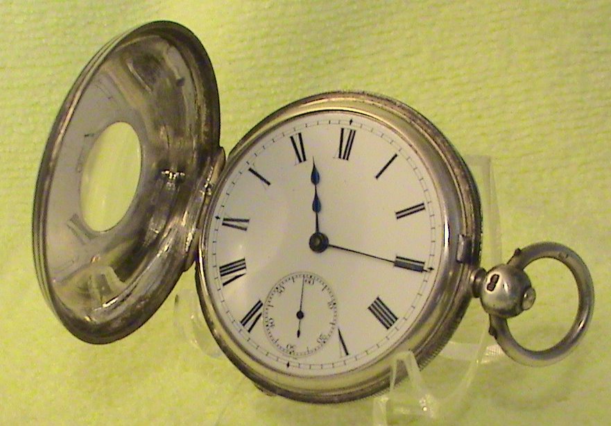

This came out ion eBay with very little description. I saw the extra spade hand and noted the silver case and became the sole bidder for fifty bucks and change.

David AbbeI examined the case with covers than "schnick" open and closed like a well tuned Bentley, with a perfect dial, perfect hands, solid silver, late 19th century(?) nice! So I opened it up . . .

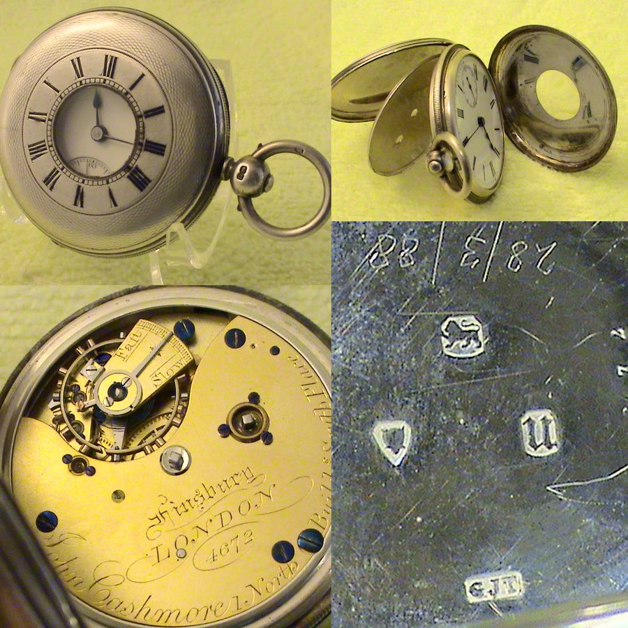

David AbbeAll I can say it WOWZA!!!!
. . . Diamond Endstones, capped escape train, (19 Jewel movment?), solid gold balance weights and platinum Mean time screws!(
), all powered by a totally intact and pristine fusee drive with the famous laminated jeweled pallet lever escapement!
Mr John Cashmore did a fine job. To bring this back to running order, I am sure it only needs cleaning and TLC. BUT . . . I never did a fusee, and this is too nice for a "first try" so should I do it, or should this go to Chris???

Tom BrownNice buy David, you sure stole that one.
In Loomes it has;
Cashmore, John London (North Buildings), South Place, Finsbuer) 1857-86, then Eldon Street, South Place, Finsbury, London 1890's

Samie L. SmithDavid that,s nice and for 50.00 bucks wow what a deal.

Buy? Theft for sure ! (or sold by a 'colonist' who doesn't know how to work a fusee !)
Fact:
hallmarks Sterling -- London assey -- 1875
Case maker: George James Thickbroom - London - registered Dec 1874 (picture identification)
What to do:
There is always a first time. If you feel uncertain better take a fusee movement with a broken dial for training.
Have fun

John WoolseyBeautiful Steal David!
A man of your capabilites should be able to eat a clean and service on a fusee!
No different to any other watch, just another pile of bits and screws assembled to make a watch!
It's the chain that can be a fiddle to clean, refit and pre-load, and is what causes many to balk at doing them.
Once you get the knack they're not so bad.
Beware though, these can suffer bad wear on 'non jewelled' pivot holes and pivots, and may need re-bushing.
You may also find in these cases, someone's beaten you to it and 'punched up' the hole with a 'centre pop' to close them up!
Even London made watches don't escape this brutality - hopefully you'll be lucky!
