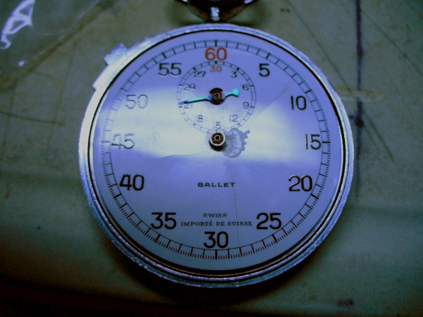

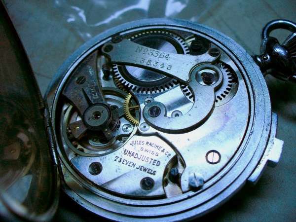

I have a Gallet (Swiss) 16s (Jules Racine) Stop Watch. It ran when I received it, but now will not wind. (A stem problem)It has a lever on the left side that slides up & down (Stop/Start) Also the hands are missing. Can anyone tell me something about it?
I have pictures if needed.

Patrick WallinGsllet Front & case w/lever
October 15, 2014, 18:10
Gerald ZimmermannOh a nice one:
Football/basketball timer 1/5 seconds; 30min register. The side-slide stops and continues the timer on Time out's

Paul D. TrombleyInteresting... 1/5th second is 1 beat on an 18,000bph movement. The most practical increment to capture on a dial.
