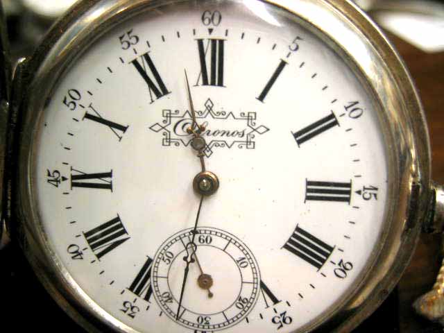

The following pictures are of a Russian language marked "Chronos" 15 Jewel with a Jewel mount in the Hour Hand. This is a well used and very clean running Silver Hunter-cased Key Wind, Key Setting Swiss made watch that came (most recently) from on the Gaspe Peninsula (south shore of the St Lawrence). It also has a uniquely home-made looking key that works very well. Anybody have the slightest clue about who, where and when this was made?! ![]() | ||

David and John, My very rusty Russian, coupled with some changes to their language over the past hundred years, tells me that the text on the cuvette reads something like... Russian Watch 15 jewel lever Chronos (at least phonetically) Accurate Movement (roughly) Interesting to me that the "Chronos" name is in English (or at least uses Roman alphabet) the on the dial, and Cyrillic on the case. No idea who made it, but I'd guess late 1800s. For what it's worth, Cary | ||||

Thank you Cary. The translation fits on all points, even as dirty as it is, it is about 5 sec'day accurate even now. Also it is temnperature compensated, as the room it is testing in varies from 45 - 80 deg F. (Our so. Cal. Bedroom, we leave unheated). The Beautiful casework, Pinned dial, and Key wound movement tell me late 1870's. Using the Latin-Roman naming on the Dial was probably a "class act", kind of like all the English-worded Store signs in Asia. Time for a careful cleaning and inspection. I think I will turn this over to my Russian-Born "Maestro" who still makes his own parts (when need be). He was trained in Belarus, and can also translate excatly what it says and maybe research the mvt. even more. | |||
