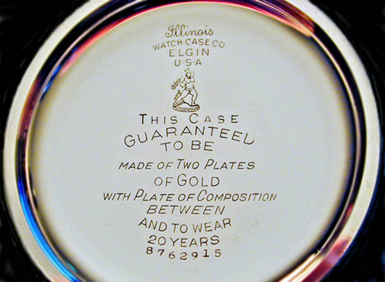

Here is one of the more creative content descriptions...

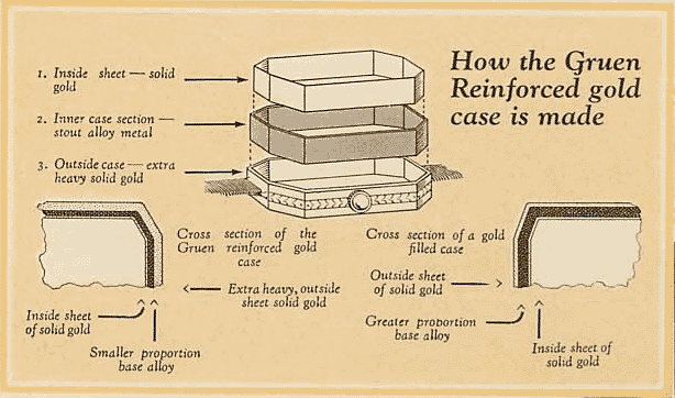

Hi, Lindell is right about the general classification of all the gold filled cases. However, I do think there is some merit to Gruen's claim to 'reinforced gold' or 'reinforced with extra gold' unseen by other makers. The following is a diagram taken from Gruen's guild catalog:
