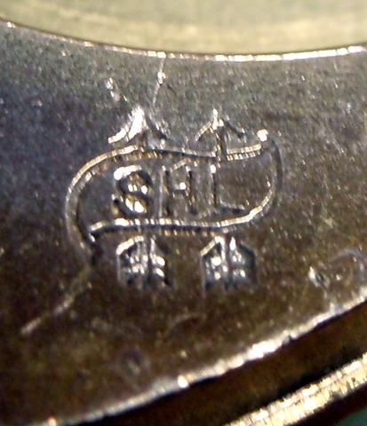

I am in the process of cleaning a pocket watch that I was wondering if anyone knows the mark I found under the bridge.

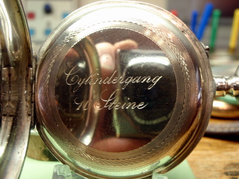

The case appears to be German made, it is marked with the crescent moon & crown 0.800. The dust cover is marked Cylindergang 10 Stein.
Here is a photo of the mark under the bridge.

Gerald ZimmermannHi Tom
SHL - 'Langendorf Watch Co.' = 'Uhrenfabrik Langendorf SA'; Langendorf, Switzerland, founded 1872.
Gerald
August 07, 2009, 15:07
John WoolseyHi Tom,
Enjoy playing with cylinder watches
Langendorf in the 60's also used the trade names of Lanco, Lancyl & Lonville for its products.
The link below will take you to some history of the company.
http://sometimeago.itsens.nl/c...f_watch_company.htmlBest regards
John

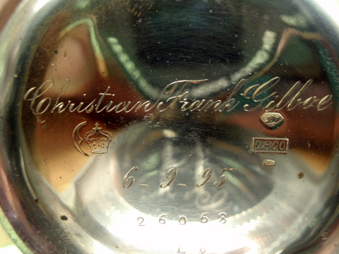

This is one of two watches I bought, the other is American made. They belonged to a gentleman that was born in Norway in 1880 & came to this country in 1900. He went on to become a Senator in the state of Montana.
He was apparently given this watch right after his 15th birthday, from what I have found he was born April 5, 1880 & this watch case is engraved with his name & the date 06/09/1895

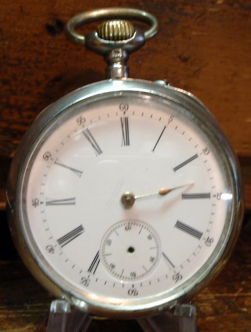

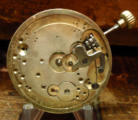

Tom BrownHere is the movement back together & running so far.
August 07, 2009, 15:53
Tom BrownDial side.
The watch still had it stops works intact.
August 07, 2009, 16:58
Tom BrownHere is the movement back in the case. I am in need of a minute hand for the watch, to match the hour hand it would need to be gold colored. The diameter of the shaft is 1.38mm & the length from the center of the shaft to end it would need to be about 18mm long.
The second hand is also missing but unfortunately some time in the life of the watch the shaft was broken off.
August 07, 2009, 16:59
Tom BrownThe inscription in the case back
