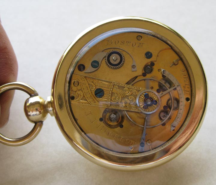

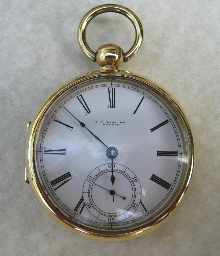

Well Keith, having a bit of machining skills, I make my own cases for some of my fusee movements.
Finding a proper case turned out to be a futile effort, so starting with 2-1/4 brass round stock and about 20 hours labor, a new case is born...This J.J. Bigelow English fusee was my second attempt, I have made a case for a nice 19jwl. Philadelphia Watch Co. movement...
Harold

Harold Visser
Here is the backside...

Very nice case Harold, and great to see these old movements being 'cased up' and used again.
Do you use a form tool for the band and curves on the back and bezel, or is it 'freehand' work?

Harold: Since I see no case screws, do you make the movement swing out from the front?
Jerry Freedman
