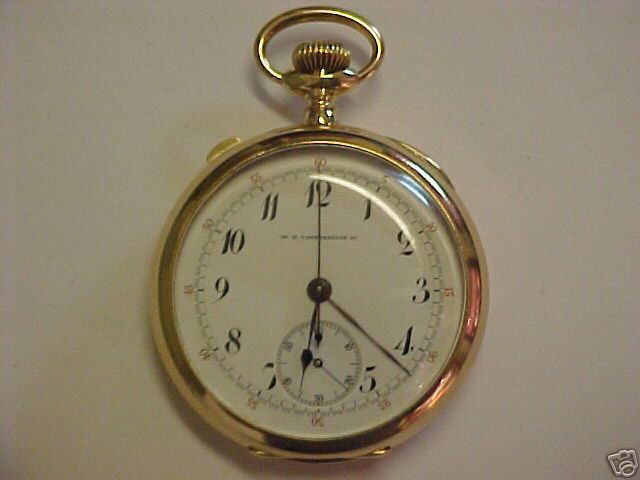

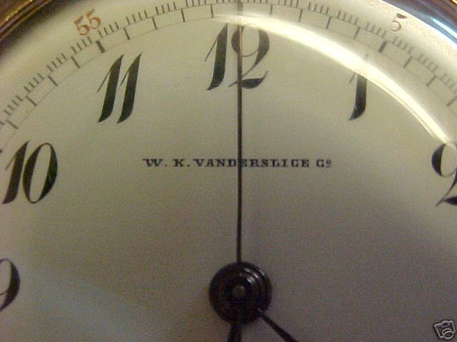

Not beat a dead horse to death but this watch intrigues me. I believe it is an Illinois but I'm not sure. Please help!!

Jerry TreimanThis appears to be a Swiss watch (nice too!). What led you to think it might be an Illinois?

Steven A. CohenJerry,
I looked in Shugart and Illinois is the only one I saw that makes a watch that is a chronometer but I don't really know?? Thaks for your help
May 01, 2006, 19:00
Jerry TreimanA regular watch with a stop-watch attachment or complication (like yours) is a "chronograph". A "chronometer" is a timepiece that is adjusted to very specific timekeeping standards and may use a special escapement, although the term was more loosely used as a marketing tool by some companies. I am not aware of any chronographs by Illinois, although Waltham produced a number of these, as did Elgin, Hamilton and even New York Standard.
