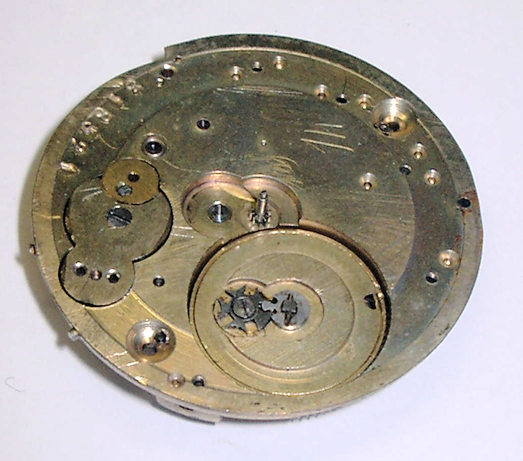

In the spirit of 'A picture is worth a thousand words', I've posted below some photo's of the Geneva stopwork for those that have never seen it And, the Infamous barrel bridge that haunts these movements to illustrate what a lousy contraption it was (is)!.
One point I forgot to mention with those things, is that the mainspring barrel is Only supported by the top of the bridge, it has No bearing, Bridge or cock of any description on the underside as you can see in the photo, hence the excess wear and sawing of the bridge in half!.
Later movements have the dial plate fully across that area and a pivot hole bored in it.
Another weak point on these movemnts is actually the stopwork, as the 'Tit' breaks off the driver on the barrel arbour! This contacts the slots in the 'Maltese Cross'turning it on each rev of the barrel, once the large 'wedge' goes full circle and hits the other side of the driver, it locks the mechanism ....... of course, then as now, there's always some gorilla at hand to 'push the envelope'....!

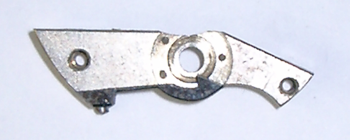

John WoolseyThis illustrates just how flimsy the bridge on this type of movement really is.
It doesn't take much imagination to understand what an almightly pig they are to repair!
The pivot hole in this bridge is 2.2mm diameter, and the remaining lip of metal between the ratchet tooth and pivot hole is ......0.3 mm!
John.

John WoolseySide shot of the same bridge, it's actually 0.65mm at the centre ......not a lot of meat to secure a bushing .... if you dare broach the hole out to take one ........ and they bend and break sooooo easily!
John
December 03, 2006, 15:51
John WoolseyThis shot shows the top of the bridge without the dust cover for the key shaft, and is representative of the majority of Swiss bar bridge movements you are likely to come across.
You will no doubt feel relieved to know Jason, that your watch probably has a lot more meat around the pivot hole than this specimen (which isn't actually too badly worn)!.
Hope the photo's are found to be helpful!

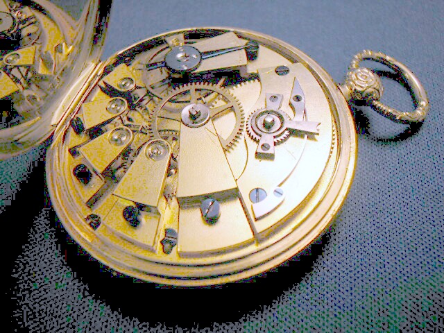

Ethan LipsigYou guys have been having so much fun with Mr. Lane's watch, I thought I would let you dissect a watch I have with a similar looking movement.
December 04, 2006, 11:58
John WoolseyHello Ethan, thanks for posting the photo,
Looks like a common ebauche being used in those days, which was kitted out by whichever maker was buying them in.
Shame many of them are un-named.
I never like to think of watches as being anonymous, as some old boy somewhere (or even a young one) spent hours slaving over each one to create them!
Your watch has a Swiss sidelever escapement too, but appears to have polished steel one piece pallets rather than jewelled.
Balance looks like an uncut mono-metalic type with timing screws and a flat hairspring.
I'd be interested to see the balance on Jason's watch ............ if he can be persuaded to let it stop and take a shot of it
It may even sport a Breguet overcoil if he's lucky!
John

Ethan LipsigJohn, I agree with your assessment. This watch is in a pretty 18k hunting case. Its cuvette reads "Henry Courvoisier & Co., Geneva, Detach'd Lever. 15 jewels, #14847." The dial is unsigned. Whatever the movement's design shortcomings, it runs well and fairly accurately.

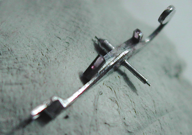

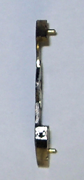

Jerry TreimanJohn - most of the Swiss bar movements I have seen with side-lever escapement DO have jewelled pallets, but the jewels are often not visible unless you look closely. They are set in horizontal slits in the pallet. From the top they look like plain polished steel. This counterpoised fork is from a movement nearly identical to Ethan's.

John WoolseyMark, that enthusiam of yours comes bounding right off the page ....brilliant!, and you're welcome to pick my brains anytime..... so long as you leave me some over to do useful work with
The copper pins you can see are as Ed states, soldered to the back of the dial, and the screws next to the pins lock them & therefore the dial in place.
You will also at some point find on older movements, a separate brass dial plate on the movement to which the dial Is secured by taper pins, the whole thing including dial then secured to the movement by taper pins also.
Others still, may have retaining screws into the side of the dial plate.
If I may enlarge on the dial screws, it may help prevent the unwary having accidental disasters with (possibly very rare and expensive) enamel dials!
The screws which Ed talked about are indeed notched on one half to clear the pin and allow it's entry through the dial plate. The screw heads usually have a sharp edge ground on them for the remainder of the edge, which bites into the copper pin as the screw is rotated.
Now, the dial screws are actually
'Unscrewed' from the dial plate in order to clamp the pin and lock it. Obviously if you continue to unscrew them, they will move further away from the dial plate - and pull the pin harder due to the mechanical efficiency of the threads.
If you continue to screw them out, it will force the pin further away from the copper backplate to which the enamel is fired as the dial can't go further than the movement plate it's actually sat on.
If you're lucky, you could reach the cut away side of the screw head again as it rotates before any damage is done to the dial (or strip metal off the pin) - and the pin will be released.
If you're unlucky (usually) the pin will either tear off and / or distort the plate ..... and a big lump of that treasured dial will fall off directly over where the pin is (was) soldered ..... along with creating some very not so nice hairlines!
When the dial screws are tightened (Remember - actually 'Unscrewed'), you only need sufficient force to pull the pin and dial until the dial is nipped to the movement and No More! Also make sure the holes for the hands are central to the pivots.
When Removing a dial, Always 'Tighten' the dial screws INTO the movement until the flat clears the pin, Never Ever 'Unscrew' them even if the clearance flat is near the pin, you'll probably break the dial!

Jerry, fantastic shot of the pallets, can't get them that crisp with my camera (4.0MP Pentax Optio 430RS) what's the secret?
The jewels shown are the 'Slips' that I mentioned earlier in the thread, so it's great that you've posted an example here.
If you take a look again at Jason's watch, the pallets are actually full jewel stones, not slips - and that is very uncommon for that or even later movements of that type.
The problem with those steel pallet arms is they're fiddly and expensive to repair and (relatively) heavy. Coupled to the length and weight of the lever, this gives the roller jewel a hard time unlocking the pallets.
The counterpoised arm has to match the weight of the lever the other side of the pallet centre to balance it, so adding to that weight which is moving all the time the watch is running - and stoping dead on each locking. That's a lot of mass to shift!
Later jewelled pallets generally have a much thinner arm and the pallets are shellacked into notches cut into it directly (as with modern watches) rather than a separate steel arm screwed or rivetted under or on top of the lever. Consequently, the whole arm, even the counterpoised part is lighter.
Some of the lever mass is also transferred to the pallet staff which has to be thicker in diameter to compensate for the loss of material in the arm, but as it's a rotating mass rather than oscillating, has virtually no effect on the moving mass of the arm except to reduce it.
This design also means a thinner movement as the lever and pallets are sited as a unit directly next to the escape wheel. It also removes the need for either clearance height or a 'sink' to position the arms next to the wheel, which also affects the heights of the balance, escape wheel and pallet staffs and, where the roller is situated.

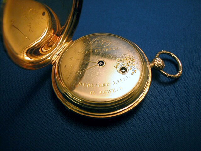

John ArrowoodHere's another bar type movement. Cuvette is marked Robt. Roskell, No. 4170, detatched lever, 13 jewels.
December 05, 2006, 16:14
John ArrowoodMovement. Large jewels ("Liverpool windows"?), side lever, I can't see enough of the pallets to know if they are jeweled, solid rim with three pairs of timing screws on the balance wheel
December 05, 2006, 16:17
John ArrowoodCase appears to be solid gold, I can't find a hallmark anywhere on it. The back is decorated with a hunting scene: a stag and two dogs. The decoration looks three-dimensional but is not.
