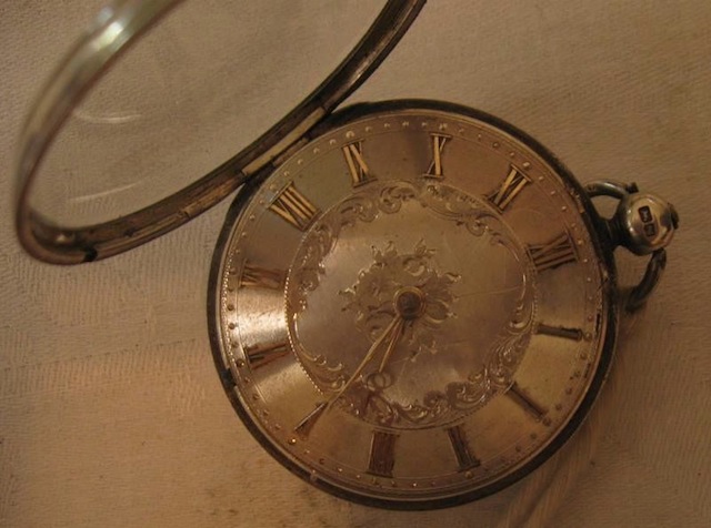

Here is one I tackled a few years back - O picked it up for $10.00 at a gun show. The chain was tormn out of the barrel, so I cut the groove a little further back, and drilled a new hole and pinned the chain. The dial is opretty beat up, but the price was right. Smile
