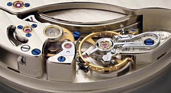

The REMONTOIRE was a slave drive spring that got its power from the mainspring. The salve spring would only get a few seconds of power & it was this slave spring that then powered the escapement. So the mainspring didn't actually drive the escapement so this slave spring helped solve the problem that the fusee could not completely solve.
Here is an image of one I found on the web, but I guess they came in different styles, the REMONTOIRE is on the left.
REMONTOIRE

Hummm. That thing doesn't look anything like my watches.
