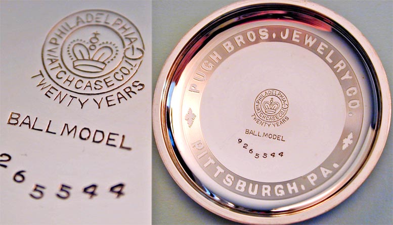

In the merged image below, you'll see an entirely correct "Ball Model" marked Philadelphia Case that also has the additional bonus of having what I consider to be especially beautiful "Pugh Brothers Jewelry Co. - Pittsburgh, Pa." markings. I'll be interested in your comments about this one.
So nice Smile it's signed not once or twice but thrice Eek three times...

Thanks for your help;I came across this case on an Elgin that I saw on ebay...Unfortunetly I let it go,I just wasn't sure about it-Until now! It's exactly like the model on the left in your picture-and now in someone elses happy hands.
I think the plain look of it threw me;and it sure does look like a forgers dream come true. I'll be on the look-out for another of these,maybe next time I'll win the auction.
If you ever see a fake that I could study,please let me know! Besides lousy work how could one be spotted??

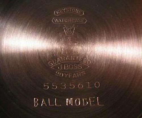

Excellent question, as I mentioned there are those who will deface a case using crudely done hand engraving in an attempt to pass it off as "Ball Model" and we see them occasionally in eBay auctions.
And now... here is a forgery!
I call this a "rusty nail" or "dremel tool" attempt...
