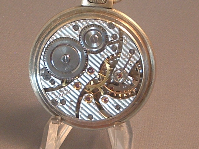

Larry BuchanBall Record 435B Movement Serial No. 2714

Larry BuchanA close-up of the shockproof Kif (Duafix) and Incabloc jeweling

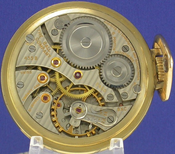

Roger StephensWell,I got the watch a couple of days ago.Was surprised it is in a Ball case.Is that normal?It is missing the regulator whip and the seconds hand is a little long.Overall pretty nice and ran for 42hrs. about 5 seconds off of my computer.Any comments good or bad would be appreciated. Roger
July 09, 2011, 14:07
Roger StephensMovt.#1 S/N 2429

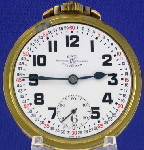

Roger StephensBall Offical Standard

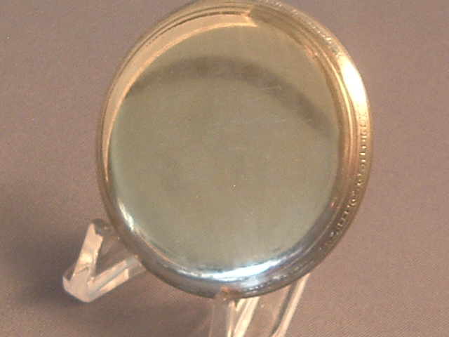

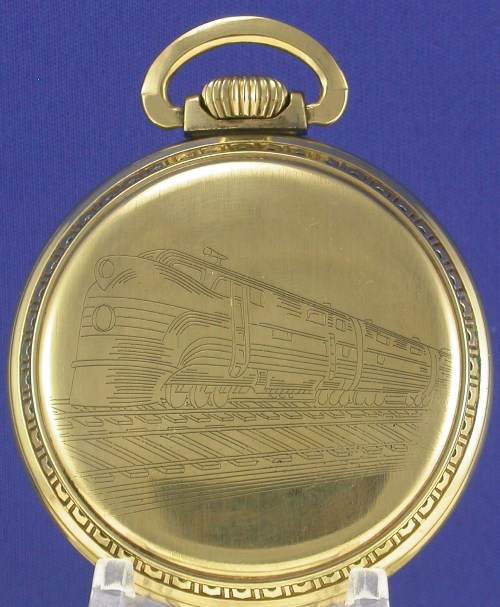

Roger StephensBack of case

Theodore J. Brown Sr.Nice Roger, you did good!Case looks original, since there's no 6 minute lever slot.
July 09, 2011, 17:49
Larry BuchanRoger:
Your Ball Record 435B looks great, and the ball case is a bonus, nice if you could find a stirrup bow for it.

Roger StephensBuster,I know you are right but I just had to have this one and the price was right. Larry just noticed your watch is s/n 2435 and mine is 2429.So I guess mine is older than yours

Great observation I didn't notice they were six serial numbers apart.

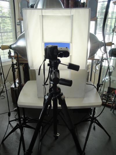

Here are some photos of my camera and close-up set up I use to take my pocket watch photos, the first shows my light tent and auxiliary lighting I have two bulbs in the box underneath the tent, two sidelights, and one overhead light.

Larry BuchanTaking photos
