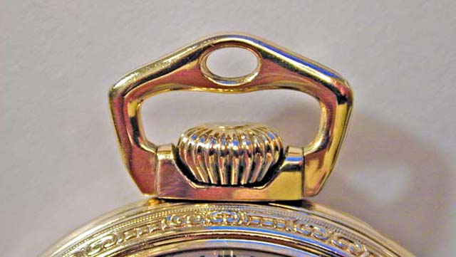

Those Fahys cases such as yours are among the best and those marked "Permanent" are the best of the best. Wink That being said the amount of wear you describe sounds considerable, so perhaps a good beginning would be to carefully compare yours to the image below this message. Look very closely at how the bow should fit into the pendant very tightly. You probably figured out those "pins" you described are designed to guard against the bow being pulled off the pendant in hard use.
Our friend Leon Harris could possibly restore your pendant with gold solder, perhaps an image of your pendant and bow area would help to determine what would be involved.
Close-up details of a Ball 20th Century bow and pendant...

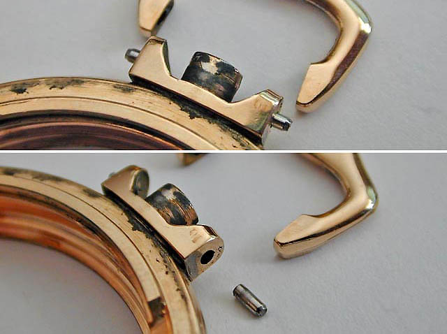

I am hoping the extra time it took shows in what you see below, hopefully this will explain these bows and how the repairs are done. Let us begin with a later case. The bow on these is "pinned" and is one of the most reliable designs. It was used on the "J. Boss Railroader" and the later style of Howard Series 11 Chronometer cases. We find it on the Hamilton Railroaders and on the last Ball Stirrup-Bow cases.
Looking at the first merged images, a very dirty case with a "floppy" bow is disassembled. I carefully spread the bow slightly to remove it. You see the retaining pins in the upper image. Then in the lower merged image the pins are removed. After cleaning the pins are inserted from the outside and then the re-formed, tightened bow is slid over the pins. Then the pins are pushed, forcing them outward for a firm fit.
First steps in straightening, tightening and realigning the bow...

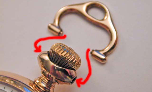

Now, we move to the 20th Century bow style as found on Paul's watch. This is an earlier, simpler style that must fit very tightly in order to work properly. In the image immediately below, the bow is spread slightly to remove it. After cleaning, re-forming and proper tightening it will be very carefully reinstalled.
Here are the details of how Ball's 20th Century style bow works...
March 02, 2008, 19:25
This bow showed somewhat more wear than Paul's and in the end the job turned out fitting well.
Finally, here is the bow reinstalled, so tightly it actually squeaks...
