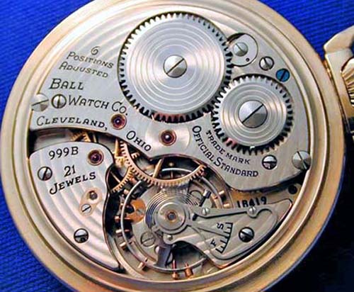

I was told that some 999B watches were Elinvars and were not marked, but the way you could tell was if it had a silver balance wheel and weights.Is there any truth to this. Thanks Nick

It would be easier to respond had you included your movement number for clarification.
All the Ball 999B movements are clearly marked as such, but will not have specific "Elinvar" markings. However, they do have an "Elinvar-Extra" hairspring and solid balance wheel as shown in the image below. On both these features they are identical to the contemporary Hamilton 992B movements. Production numbers on the Ball-Hamilton 999B are detailed along with all 16-size Ball-Hamilton movements here...
16-size Ball-Hamilton 999 and 999B Movement Numbers and Years Listing
Hope this is of help to you and others.
Typical Ball-Hamilton 999B from my collection...September 12, 2012, 19:41
