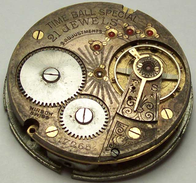

The following is from a Tariff Schedules Hearing by the House Ways & Means Committee from 1913, the part I copied below contains statements dated 1909 by Webb C. Ball, General Time Inspector from Cleveland, Ohio and Edward A. Marsh, Watchmaker from Waltham Mass. I thought it was interesting about the inspection of the Swiss Fake & I have seen Swiss fakes with the same markings listed on Ebay over the years.
_______________________________
I have before me a Swiss-made watch which was brought into my office yesterday by a man who loaned a railroad employee $5 on the watch. The markings on this watch are as follows: "Missouri Pacific," "Specially Adjusted," "Extra quality," " Highly 23 jeweled," " Swiss." I find it has five jewels made of glass and the center jewel, one of the most important bearings in the watch, has the appearance of a ruby, but upon examination we find it is made of red wax.
The markings on this watch indicate that the figures giving the number of jewels at 23 were stamped on the plates after the watch passed through the customhouse. This is certainly one of the worst frauds that has come under my observation.
I have another watch movement before me which was recently detected in the hands of a railroad employee. It bears the following markings on the plates: "Ball Special," "23 ruby jewels, "Adjusted." On the dial is also marked "Ball Special." The numbers 23 were stamped on this watch evidently after it passed through the customhouse, as it is a very rough job, while the other lettering is plain and well done. This watch has only seven glass jewels. The general inside finish of both watches and under the dial is very rough and poor.
During the years I have had charge of this time-service work we have detected and taken out of service hundreds of such dangerous machines, and I do not know of any greater protection that can be afforded the traveling public, the shippers, the employees, and the railroad companies than the enforcement of the provisions in paragraph 189 of the tariff bill; and, furthermore, these same provisions will protect the integrity and high standing of reliable Swiss manufacturers who have spent large sums of money and years of patient skill and experience to produce watches that can be depended on and have gained a world-wide reputation. Certainly no harm can come to them or American merchants and their customers by having the provisions in paragraph 180 of the tariff bill fully complied with.

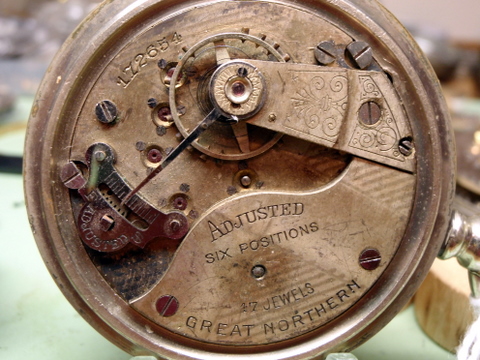

I have this day made a careful and detailed examination of a watch movement, on the top plate of which is stamped the number 172,654; also the following words: "Time Ball Special," "Nonmagnetic," "Six positions," "Highly 23 jeweled" also the word "Swiss." On the steel cap covering a portion of the regulating mechanism is stamped the word "Adjusted." On the dial are the words "Time Ball Special" and "Jeweled" in Roman letters, and over the second circle the word "Adjusted" in script.
This movement would be briefly described as "18 size, open face, full plate, stem winding, and lever setting."
The construction would be technically known as a "4 pillar model," with a "right angle escapement," and "going barrel.
In detail it is described as follows: The plates and bridges are of brass, but plated to represent, or imitate, nickel—that being the metal used in the majority of American watches and used exclusively in the higher grades.
The workmanship throughout is coarse and the finish is cheap. The top plate contains four jewels, which are set in the plate itself, although there is an attempt to represent separable settings by surrounding the jewels by circular lines and by the insertion of screws, such as are used in high-grade American watches, to secure the jewel settings in place. The balance cock contains the usual two jewels—a "hole" jewel and an "end stone." The lower plate contains no jewels.
The potance. or lower support of the balance staff, contains one hole jewel corresponding to that in the cock or upper support of the balance staff, but in place of a jewel end stone a flat steel disk is used. The pallet (which in all ordinary American watches contains two jewels, which act upon the teeth of the escape wheel) has no jewels at all. The roller; in place of the ordinary "jewel pin," has merely a piece of brass wire. The entire number of jewels contained in this movement is 7, instead of 23, as stamped on the top plate. Note that the figures "23" are not stamped, but were evidently engraved after the watch passed the customhouse. The body of the balance wheel is composed of a single piece of nickel instead of being bimetallic, as in the regular compensating balances. The rim screws in the balance are really imitation screws. The hairspring is so badly out of proper shape as to be entirely unreliable and would render impossible any adjustment of the watch to varying positions. Concerning the markings on the top plate, it seems evident that the word "highly" and the word "jeweled" were widely separated for the purpose of fraudulently inserting a fictitious number, so that while this movement could be invoiced as a "seven jewel" movement, it could after customhouse inspection be engraved to describe, represent, or indicate any desired number in excess of seven. The difference in the appearance of the figures and the words between which they appear gives strong evidence that this was done. Furthermore, it seems evident that the name "Time Ball Special" was adopted and used to mislead purchasers into the belief that they were buying a watch commonly known as "The Ball Railway Special", Mr. Webb C. Ball being chief time inspector on 70 of the railroads of the United States, covering more than 60,000 miles. This belief is confirmed by the accompanying letters from E. J. Heather and Webb C. Ball, the official time inspector above mentioned. While the words "Nonmagnetic " are not [only] absolutely false in fact, their assertion with other markings, which are entirely false, justifies the assumption that they were used with the intent to deceive and mislead the ignorant purchaser.

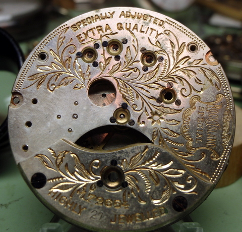

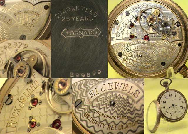

David AbbeTom, that suggests that there were a few more than just 1 S/N17265 "Ball" watches made!
I got mine because "Rock Island" sounded a little more "Railroady" than "Time Ball".
The interesting thing is that on mine all the parts work as promised. If the Cap Jewels are glass, that is OK because they lapped them flat and the pivot jewels are all good press fitted type. The only fake is the center bottom main wheel jewel, and I think that is just red wax (real hard but waxy). Basically it is a 15 Jewel movement with 3 pairs of caps (6 more Jewels) for the 3rd wheel, escape wheel and pallet pivots. I am not really sure the caps do anything because the staffs look straight, but they could still control end-play (I guess). Of course position accuracy is "out the window" because to poise that Balance wheel would take more than an "act of GOD".
The real "bugger" was the Hairspring that is permanently attached to the Balance cock! So to properly clean things I actually pulled the hair spring wedge wire thingy out and had to restore it after cleaning!
This was also the case with a very early pre-breguet Hairspring (1870-80's) Longines I just did, so it is not really indicative of a "Cheap" job. The Swissers were evidently more protective of the "art" of maintenance (I guess) which kept their watches out of our Railroads.
I was going to do a pictorial on this but accidentally erased the pics in my camera that I took all through the process of teardown, cleaning and re-assembling.
