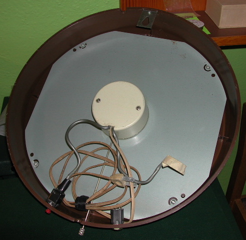

And just because I can't stop buying stuff, and don't want to.
It is a full on plug in electric, not battery operated, 14" diameter.
What do you think, 40's, 50's?
October 26, 2013, 17:17
Lorne Wasylishen
Back
October 26, 2013, 17:36
Dave Turner
I like it.
What are the two switches on the bottom on either side of the setting knob?
Dave Turner
October 26, 2013, 18:00
Lorne Wasylishen
As I understand it they are for synching the second hand, you press the red one to stop the second hand and the black one to start it again.
The push-button portion of the black one is missing but I should be able to find a decent replacement.
It can still be set exactly in the present condition by unplugging and plugging back in.

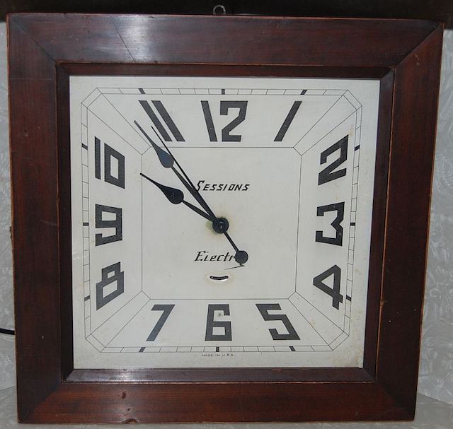

I find this interesting because I'm trying to retrofit this old Sessions with a Hammond motor to a quartz movement, since I can't keep running on the original electric motor. I'm trying to figure out what movement will work properly in it, and still keep the sweep second hand. What I read, is that a lot of the quartz movements don't recommend using the second hand as it takes too much of the battery reserve.
Thoughts welcomed.

Well Buster, After considering the quartz retrofit and concluding that most of them won't drive a large second hand like the one pictured, I think I've resolved the issues with the Hammond motor on this clock. It's back on the wall running steady for the past two days.
Reckon, I'll have to adjust it manually between Daylight and Standard time!

William, I did look at the high torque movements and was considering going that route, but I wanted to keep the look of the hands I have, and couldn't find any second hand that would look as good as the one I have. That was my biggest concern.
So, after studying the idea I think I resolved why mine wasn't running. It's been going steady now for the past week.
I think I had too much oil in the rotor/motor? In previously working on it, I found an instruction for 'flushing' out the old original lube and restoring with new oil.
And this past week I also found that if the hand nut is cranked down too tight it also causes the clock to run slow or stop.
