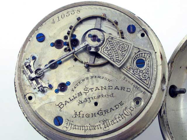

http://cgi.ebay.com/Webb-C-Ball-Pocket-Watch-Size-18-OF...QQrdZ1QQcmdZViewItemApril 19, 2008, 13:52
Tom BrownOne thing looks strange to me, I don't see the mainspring barrel arbor in the hole in the plate. Is it missing the mainspring barrel?
April 19, 2008, 13:57
Tom BrownAlso, on the dial is Ball supposed to be Balle? On the movement is it suppose to be marked Ball's? Also has a broken screw on the mainspring plate. I would be interested in hearing from the ball experts.

Harold VisserOne thing for sure, the dial has Josiah Moorhouse fingerprints all over it.....Moorhouse did work at Hampden for a while...The "mulberrys" at the 15 minute markers are a dead giveaway...
April 19, 2008, 15:51
Thanks Harold,
That makes this watch a real prize
even in its present condition.
Although as Tom correctly mentioned, one or more persons unfortunately removed a few parts over the years this one is a prime candidate for professional restoration. These early Ball-Hampden Superior Grades are hard to find and highly prized by Ball collectors.
Adding another dial comment for Tom, the circular flourishes at the end of words like Ball and Cleveland although confusing today are typical of fancy calligraphy of that era.
Thanks to Tony for bringing our attention to this one.
Note the "mulberries" that Harold referred to at 15 minutes markers...April 20, 2008, 23:34

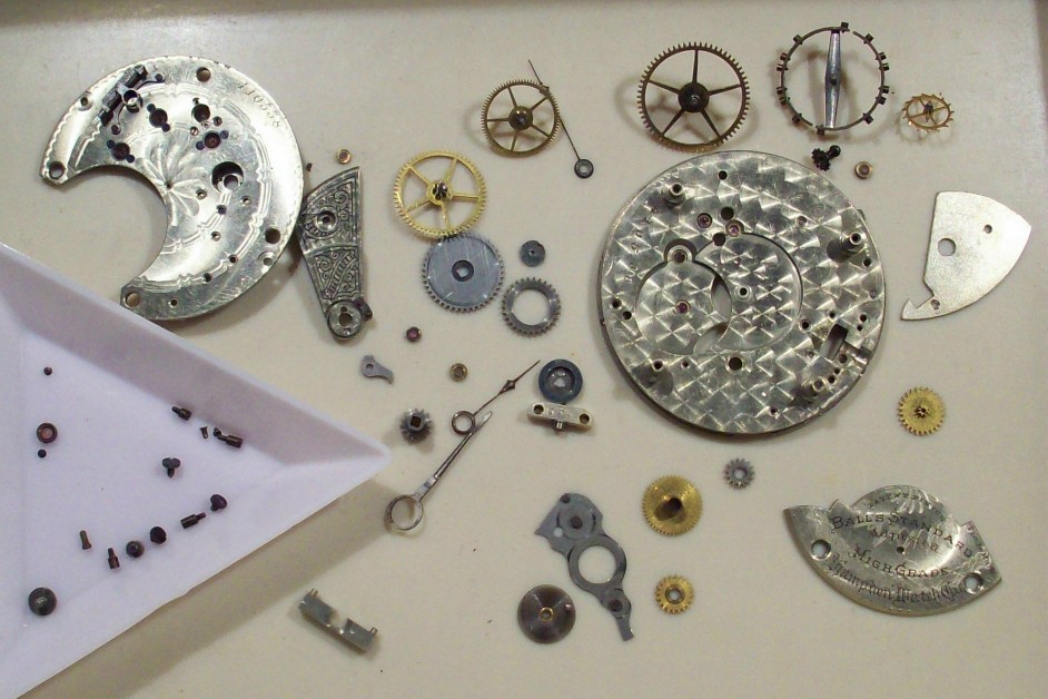

Bill KappHi again,
Well, we have taken it apart. It needs a barrel and mainspring, roller jewel, pallet fork, two broken jewels, two broken screws, and the case screws.
That said, it will be beautiful when it is finished. I am thrilled to be its caretaker.
This is the earliest Hampden Ball to have surfaced to date and it is one of three marked Ball's Standard High Grade.
The Moorehouse style dyle has markings on the back.
Appears to be 8/21 and then 9 ' C. I speculate
that this is similar to the fergueson almost look alikes that were probably done to avoid the fees invlolved. Imitation is the sincerest form of flattery!

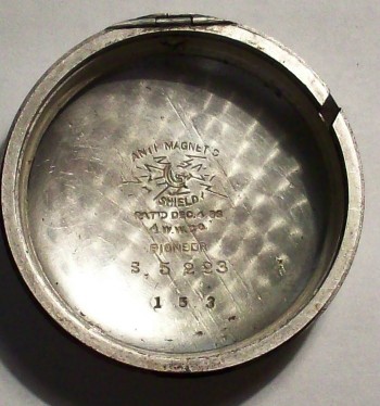

The case is two pieces with the anit magnetic shield being an insert. Both are marked as Walthams. one is pat from 79 and the other in 83.

April 30, 2008, 19:04
Bill Kappmore pics
April 30, 2008, 19:05
Bill Kappshield
April 30, 2008, 19:06
Bill Kappflip side of shield

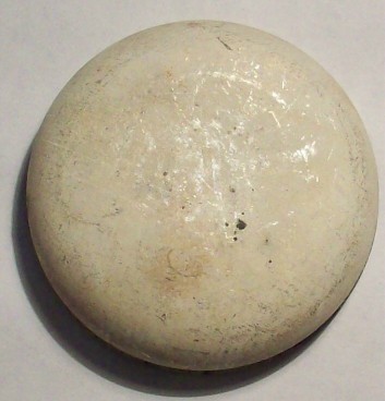

May 01, 2008, 21:54
Bill KappHi again guys and gals.
Marty finished today. In total he had to replace 6 of the jewels. One end of the balance staff was badly damaged so he had to restaff it also. A big pain was encountered when one of the pillars had a broken screw. Naturaly the hairspring had to be straightened also.
But after restoring all the parts with correct replacements, it has been adjusted to keep time to a few seconds a day in 5 positions. The coin silver case shined up respectably also.

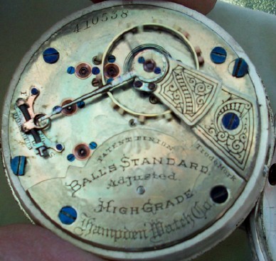

Bill KappGary Keys just sent me pics of his High Grade,
This makes 4 know survivors so marked out of a total of 39 surviving Ball Hampdens known to me.
serial # 444051
Happy hunting

Bill KappNote that it is another Moorhouse style dial.
