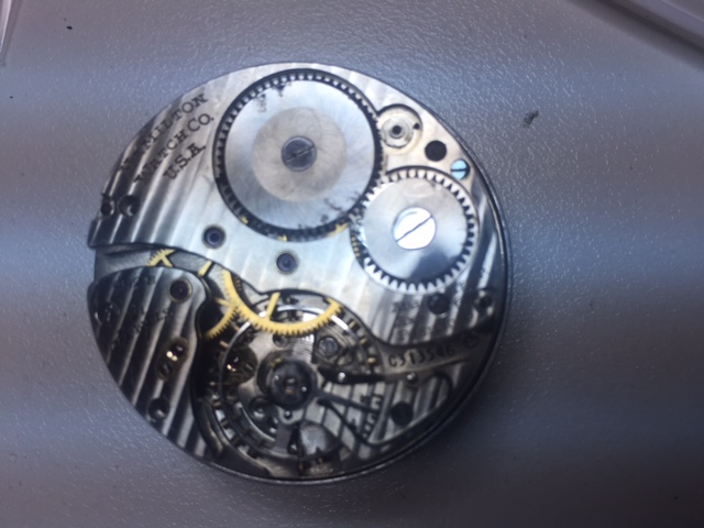

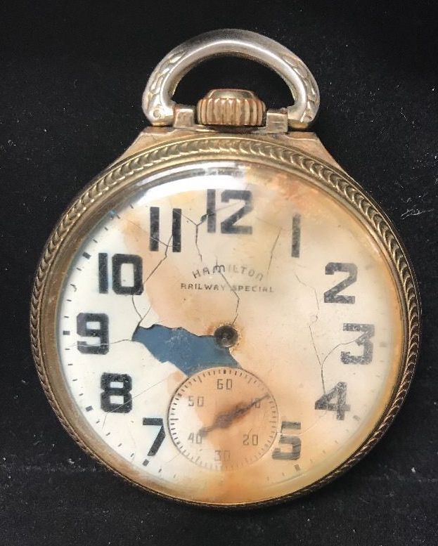

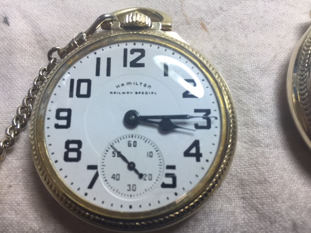

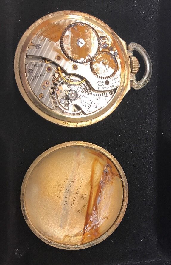

I recently picked up a Hamilton 992B that had seen water and was a bit rusty.
I decided to try and bring it back to life but after a bit of investigation I found it too expensive to get the wholesale parts needed to get it running again. So I decided to get a movement, Dial, Hands and a bow to at least get another watch back running again.
The first images are of the watch how I received it and the others are of the finished project.
I hope I haven't crossed the line in doing this but its better than having it sit in a drawer never seeing the light of day.
August 28, 2017, 19:41
Gary Dutton
Rusty Movement
Gary Dutton
Finished project
#1 image

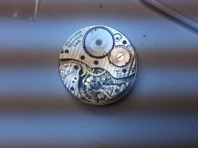

The original movement is still in pits and needs more parts to make it a worthy goer again but don't get to concerned as I will bring it back once I get the parts.
Sorry for misleading you.
When I get home tonight i'll show what I have so far.
Cheers
Gary

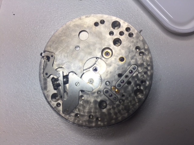

August 29, 2017, 04:23
Gary Dutton
#1
August 29, 2017, 04:24
Gary Dutton
#2
Gary Dutton
#3
August 29, 2017, 04:25
Gary Dutton

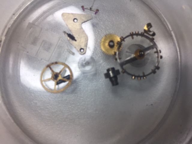

This image shows some of the parts that were rusted or broken.

August 29, 2017, 18:23
Gary Dutton
Here is a list of things that were rusty, broken or missing.
1. Dial Foot Screws (2) #649
2. Lever Shipper (1) #679
3. Lever Shipper Screw (1) #651
4. Cannon Pinion (1) #636
5. Escape Wheel Complete (1) #665
6. Centre Wheel (1) # 662
7. 4Th Wheel (1) #667
8. Pallet Fork Complete (1) #644
9. Staff (1) #659
10. Barrel Arbour (1) #609
11. Double Roller + Jewel Complete (1) #643
12. Click Spring (1) #655
As well as some more items that I found later
13. Hour wheel
14. Regulator.
15. Third wheel.
16. Dial and Hands.
17. Spring setting cap.
So as you can see by the parts list it will be a long haul and there maybe one or two more to add to the list as I start to put it back together.

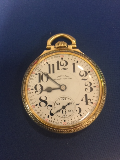

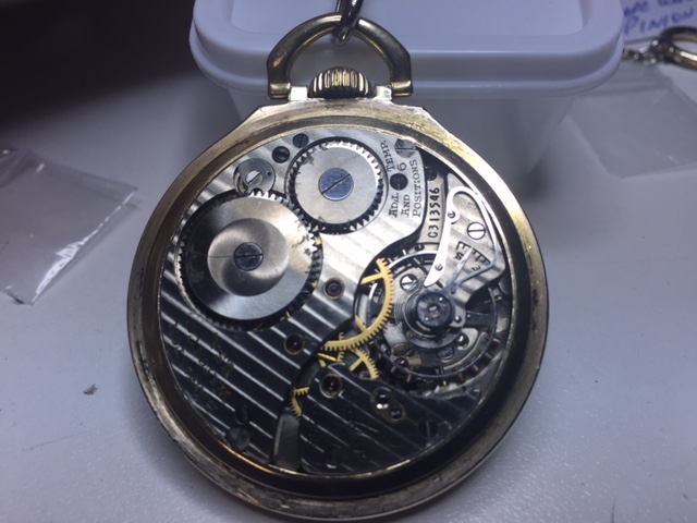

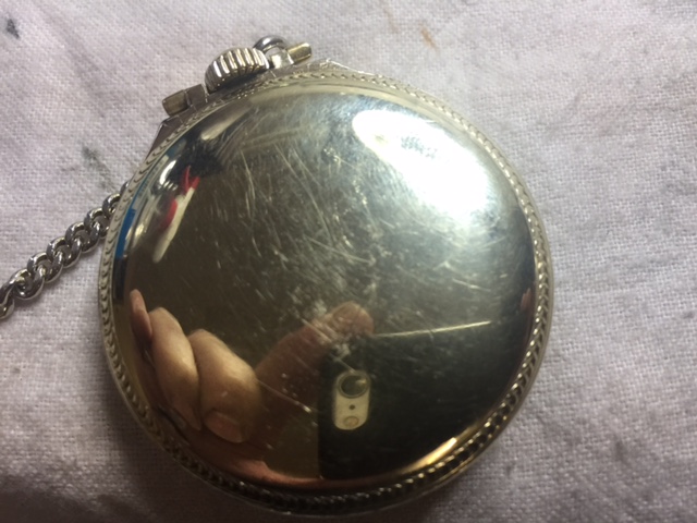

September 21, 2017, 18:15
Gary Dutton
Hi All
Well the day has come and I have finished the restoration of the rusty 992B.
I finished putting it back together last night and it went back together without a hitch but and it start up after a bit of coke-sing but then as I started to fully wind it the main spring let go and that's where it stopped. I will be on the lookout for a mainspring but I have seen plenty of them on that auction sight.
I have included a couple of pictures of the watch back in is original case with a new dial and hands.
Thanks To Gary C. for all of his help in supplying the various parts needed to bring it back to life. I never looked at how much it cost as it was never about the money it was about bringing it back to life and to see if I could do it.
Cheers
Gary
Gary Dutton
Back
September 21, 2017, 18:16
Gary Dutton
Movement
