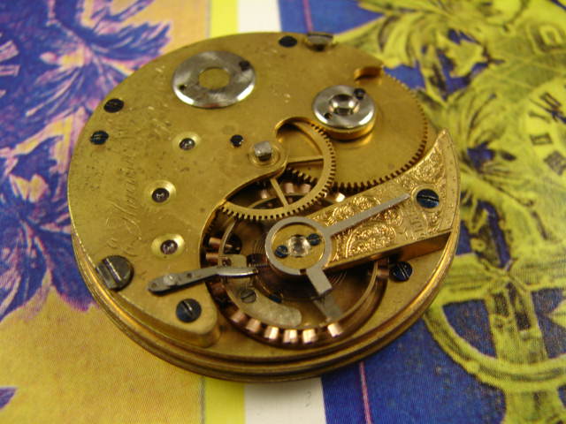

Hi all, new here and I just bought a series V, L size Howard movement. I've been sort of collecting watches for about 10 years, but this is my first Howard.
I was trying to do some research on the movement, and I can't find anything on it. It is a series V lever set stem wound movement. The dial has the 1868 patent information. Everything I've seen says that they didn't make lever set L size movements, and the early key wound movements were sometimes converted and renamed prescott. Mine appears to have originally been a key wind, but is now stem wind.

I may be totally off base, but I do believe that Abbott type 2 stem wind conversions were available for Howards. Does your watch have a lever or a toggle?

From the picture it's definitely a lever at approx. the 23 min mark. Stem at 3 o'clock. I had wondered about the Abbott conversion too, but don't know enough about them to know if a lever was ever used with them.

Curtis Meloy
Hopefully this works...I'm trying to add a pic.
January 31, 2015, 09:40
Curtis Meloy
And movement...
January 31, 2015, 09:42
Curtis Meloy
Different angle
February 02, 2015, 18:00
Curtis Meloy
Here's the under dial. Any ideas?
February 02, 2015, 19:31
This Abbott Conversion in the 1895 Otto Young Book is very different. I think you have a "factory" Lever set that is pictured in the Townsend book.
February 02, 2015, 19:39
Townsend's book shows Series V "L" size with Pendant Wind and Lever set. So you have a legit example.

Curtis Meloy
Wow, awesome information Mr. Abbe! Thank you for the illustrations, it does appear strikingly similar to plate 48 and the serial falls between plate 47 and 48.
Very exciting to think it could be a factory job. Wish I could find a dial side pic of an example of either a plate 47, or 48 movement.
I understand very few left the factory stem wind, and lever set.
