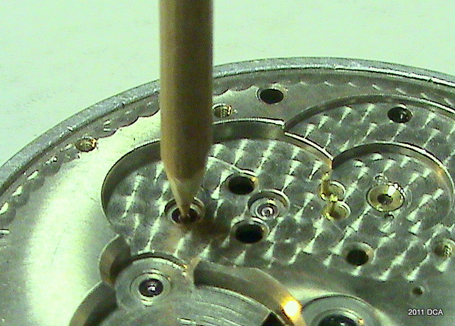

David AbbeA short walk-through of how I use Pegwood and Rodico to clean jewels and staffs; After I have spin-cleaned all the watch parts that I find necessary to disassemble; First I sharpen the pegwood to a point, then insert it into each friction jewel (those with no caps) and spin it. If there is any residue on the point, I repeat that until the jewel is clean . . .

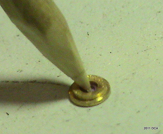

David AbbeFor the capped Pivot Hole Jewels, I do the same thing with the loose pivot jewel on a clean surface or piece of pithwood. . .

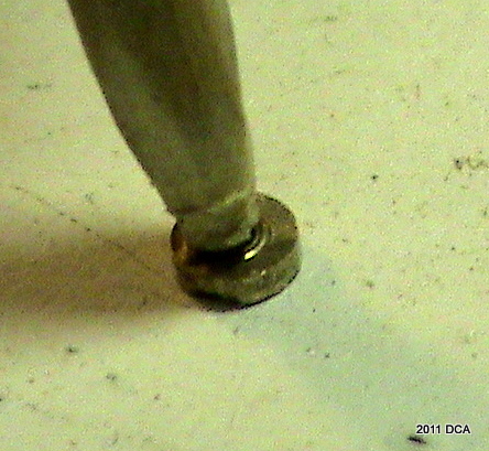

David AbbeFor the Jewel cap, I clean off the opposite end of the Pegwood and make it unto a suface cleaner that I wipe the cap jewel face with until it reflects totally shiny with no spots on the cap Jewel surface . . .

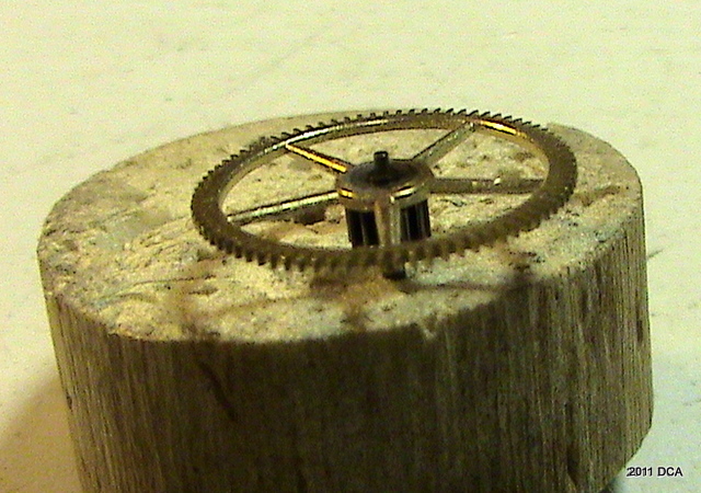

David AbbeAs for the movement wheels, I first insert each end into a pithwood and spin them so the bearing areas are been lightly polished by the light abrasive effect of the silicon in the pithwood fibers . . .

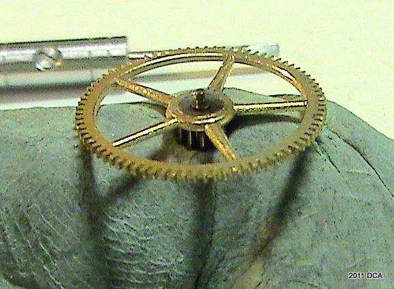

David AbbeI then re-polish the wheels in a piece of Rodico to remove the last vestiges of old crud before trying them in the cleaned plates for the "free spin" test. I also plunge the pinion parts of each wheel deeply into the rodico to remove loose debris in the pinion leaves . . . .
