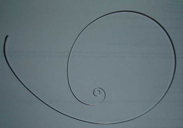

Here's a picture of it after I stretched it. Before this picture it was about 2" diameter, now it's about 6 1/2". I'm going to put it back in the watch and see what happens.

I hate to say but it will go back to the way it was once it is reinstalled.

I believe that steel will take a set being compressed more than, or at least 1/2 of it's life.
I think that what you have done unknowingly is to weaken already weakened old steel.
I believe I would chunk the old one and wait for the new one to arrive.
I believe that even with safety pinions, old barrels and train gears and pinions, that I really wouldn't want a mainspring to break and test my "safety equipment". A shock of a mainspring breaking can do a lot of damage if things aren't working as designed and in some cases even if they are working properly.
Coiled steel springs once shaped aren't meant to be reshaped as that can only weaken them further than they already are.

I tried this a while back. It does not work. The spring goes right back, and plus the effort used in straightening it often creates weak points . I imagine it would have to be reheated and retempered to make it remotely work, but a new one is the better bet.

As they say above once there set or just simply old that’s the end of useful life, these old brown steel spring once removed, relaxed, no doubt drawn out in cleaning/ re lubing and re stressed in insertion are far more likely to break within weeks of re fitting, also if the old spring seems to be functional there is a good chance give a inconsistent power output, so for $15- $30 + shipping fit a good alloy spring like starting with a new engine and often makes timing out much easier, you’re not adjusting your watch to a old weak spring. Where possible always use a modern alloy the brown steel are often many years old NOS or worse old ones saved and put back in the envelopes for me on customer watches it’s a false economy to buy the old brown steel ones cheaper maybe for home use as you can replace should they break and don’t expect too much in accuracy.
