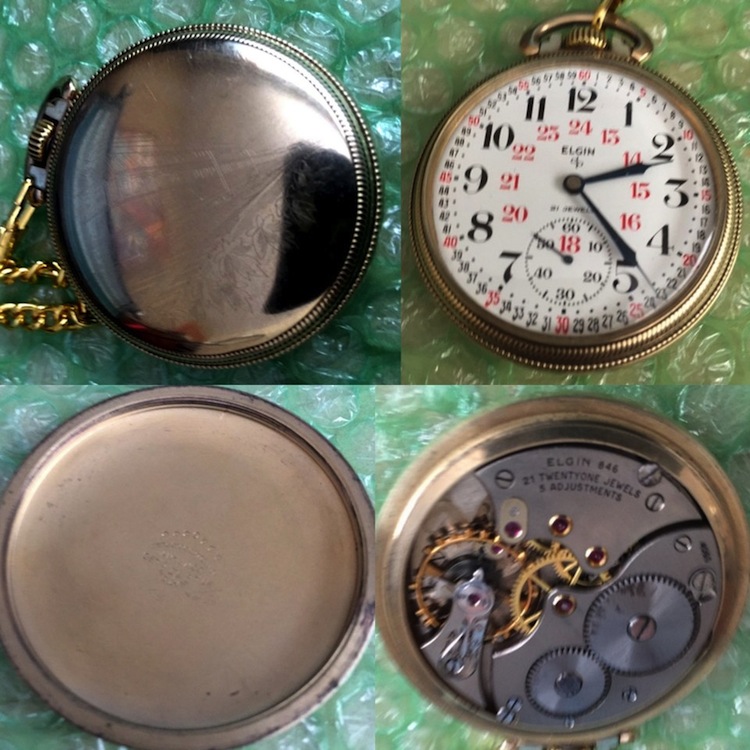

The pocket watch that I have has an:
open face Star watch Case 10 kt. rolled gold
lever set case #4,444o,444
R.R. Grade Serial # 4066
Single Sunk Dial Elgin and 21 Jewels on dial
24 hour dial Sixe 18
Montgomery dial
adjusted to 5 positions
Star Watch Case

this is a Swiss movement cased at the South Carolina plant. They do have a 4066 or other numbers on them but this is not a serial number. Most were 17j but I have seen ones that Elgin added jewels for special purposes. Elgin also did 21 and 23 jewel Burens that were cased and timed in Elgin cases.

It is a Buren version with the patent regulator, it was also available in 23j and should be adjusted to 3 positions (5 adjustments) Elgin also made these in the non-patent regulator models but the look of the dial and such was the same. The Swiss models that Elgin produced did not have serial numbers.

Mike sent them to this Dave. This is the Swiss Buren version. Nice movement. The case looks like the Great, late Burlington "Zephyr" passenger run (Chicago to MSP and points west).
Interesting that the Big Book notes the 23J Buren Model 845, but not the Buren 21 Jewel 846 . . . More Rare?
I would ignore the value and use this as a "carry watch". It sports the "look" of the RR Watch era.
February 15, 2015, 21:54

Thanks for the pictures Michael, I see it is the Swiss version, but might add that it is a very nice looking watch, being 21j and 5 adjustments.
Hopefully all the info above, by the real experts, tells you what you need to know about your watch,
