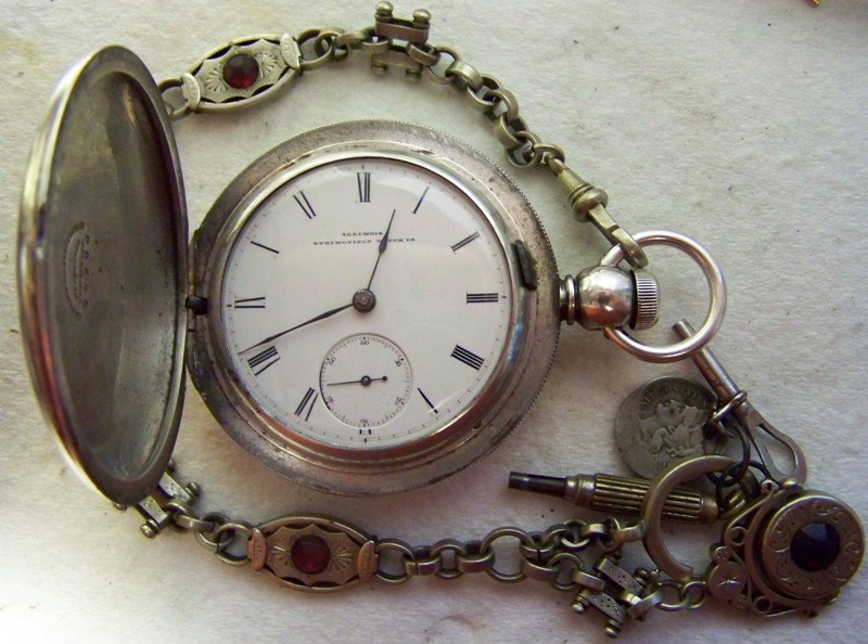

After a couple evenings of on and off work on it, I installed a new pusher, a new crystal, repaired the dial, and cleaned the movement. I added a German made chain I had with a couple keys and a 3 cent piece. I think it just sets off the watch even more. Even though I have some other 5oz and 6oz coin cases in my collection, I don't think I have any that are larger in diameter than this one. It is measuring 2 1/2" across the main body.

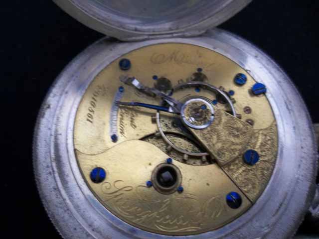

Here is the movement after cleaning. I ran this one over the last couple days and it has been keeping time less than a minute over the last couple days, pretty good for an oldie like this.
October 16, 2012, 14:15
Dave Turner
Nice job, looks good!
Dave Turner
October 16, 2012, 17:53
Eric Unselt
Fantastic results, Jared. Excellent work on the dial repair, too.
October 16, 2012, 21:02
Eugene Buffard
Great Save Jared. I'm glad to see another one saved.
October 17, 2012, 00:30
John J. Flahive III
Awesome! I love these big, old, keywinders. Cool
Well done Jared!
October 17, 2012, 11:39
Paul D. Trombley
Nice looking watch.
Not sure I would be brave enough to solder on a baked porcelain antique. Pretty impressive.

How do you shine up the gilt plates? Do you soak then brush? I have a gilt Howard and the plates are a bit discolored.. I notice your turned out nice and bright..
Bruce Byrd
October 17, 2012, 21:17
Jared Brinker
Bruce-
I use zenith cleaning solution in an ultrasonic cleaner. Seems to work very well. I typically take gilt plates out after about 5 minutes or they start to get very light in color. seems to work well but sometimes some gilt watches don't clean up the best etiher. this one did.
