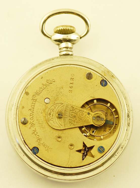

Been trying for a long time,and finally scored a New York Standard worm gear watch. I have quite a collection of NYS watches. I like the odd,and rare models. Been reading all I can find about these,but there is a lot of different and conflicting info out there. The Price guide says 52,000 production of these,but info on the net says 12,000,and only made in 1888. Anyone else have one of these?

Hi Cecil,
We re-sized your image and made the close-up below. I do not have one of these but find the worm-gear feature fascinating. Seems to me it would simplify the movement just as it worked well for decades on end in automobile steering systems. Perhaps others will weigh-in with additional information.
The worm-gear looks simple and effective...

Cecil McGee
Thanks Gerald,I read it all and it all goes with what I figured. I have a model 2,and several model 3s,and all of them as with this worm gear,fall in with their information as to serial numbers.

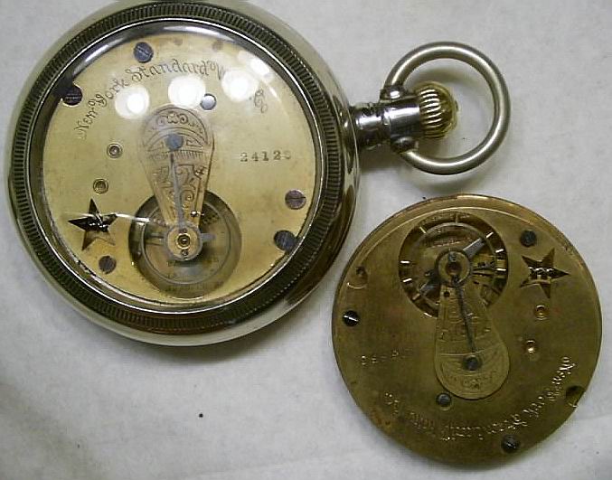

Well the worm gear watch lives. Needed a little cleaning,and a new fourth wheel,which came via a parts movement supplied by Mr. Chris Abell(thank you very much). I had this two crystal case just lying around,so it will fit there for awhile. It had the original celluloid dial,with no dial feet,just kinda glued to the movement(don't know what those people were thinking back then)it was a disaster waiting to happen.
There was discussion of the dial "snapping" into a grove on the pillar plate,not so. It just kinda fit into the bevel,and was glued. The simple act of screwing on the front bezel could twist the dial,and break the fourth wheel pinion. These watches came in hinged cases originally I am told,but still the pillar plate is drilled for a two footed dial,why not use one? Well I did. I'll keep the original celluloid dial around,but won't use it.
Now for the last delima. The parts movement that I got from Chris,is runnable. In fact it will run now. It just needed a mainspring barrel,arbor,balance wheel,hairspring,and roller table and jewel,and some winding and setting parts. These parts I got from a model 2 movement in my parts drawer. I just need another fourth wheel(the pinion is broken above the pillar plate,so does not affect the watch running),or figure a way to repair this one,and I will have two complete,running worm gear watches. I read in another thread a while back about repairing a fourth wheel,but I don't have the equipment to do that kind of repair.
So,back to square one,needing a fourth wheel for a worm gear drive. Probably lots of those out there. Yea,right.

Cecil McGee
The front. I found this 2 footed porcelain dial with the repaired chip,and used it. Later I found a perfect 2 footed dial,which I will put on later.

Cecil McGee
I tried to get a good picture of the worm drive,but this is the best my camera will do.

Cecil McGee
Very simple drive,don't know why it didn't work out for NYS. Maybe folks just didn't want a "worm in their watch".
