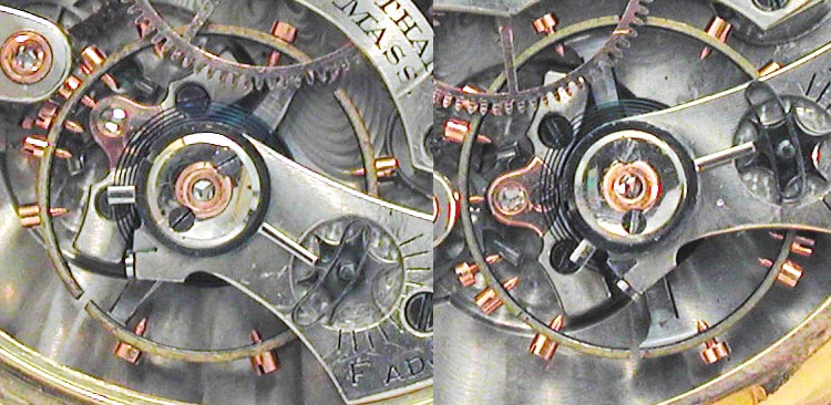

Mark, it is an age thing unrelated to grade. The first 1894 model movements had a riveted staff (and also a hook-end mainspring). You can tell which staff is used by the shape of the balance arms. The riveted staff is used on balance wheels with arms that taper gradually to the rim (left side of photo below). Friction staffs are found on balance wheels with parallel-sided arms that flare out at the rim (right side of photo).
I have not done research on existing movements, but my guess is that they began to use friction staffs about the same time as the 1899 model 16-size was introduced (which had exclusively a friction staff). The change is not documented in the records. The two examples shown, both original balance wheels, are on movements that are 7 apart in serial number in the 8.7-millions.

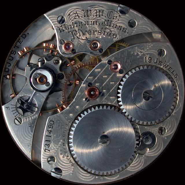

I also thought that the friction staffs came along later, until I came across this early 1894 (ca 1895) with a friction staff. The sn on the balance matches.
So... just what is the earliest friction staff that folks have found?
August 21, 2005, 01:37
Jerry Treiman
Actually, Mike, your Riverside is from a group of 2000 movements (7310001-7312000) that were sent out from the factory over a four-year period from January 1898 to August 1902. The handwritten records list these as 17-jewel movements. I suspect yours sat unfinished in factory inventory for a year or two and was upjeweled and fitted with the newly available friction staff balance when it was finally needed.
The available set of handwritten records was probably compiled in late 1902 or shortly thereafter (as I do not see any delivery dates later than that). Many of these later groups of movements (including some of the 19j Riversides) have notations about movements not delivered which I take to mean that the unfinished movements remained in inventory at that date.

I just took a look through all of my 12-size movements and, other than the example I showed above, I do not have friction staffs until the 10-millions, presumably 1901 or later. My own 19-jewel Riverside from the 10-millions has a riveted staff. Mike's is a nice example illustrating how some of the better grades were finished over longer time frames. As for my examples above, they are also from a group of movements finished over a longer time frame, and judging from the case style on the friction staff watch it was sold after 1910.
August 21, 2005, 02:13
Mike Miller
Jerry,
That is remarkable! Great detective work. I hadn't thought about these sitting around unfinished for so long before shipping out. The upjewelling was cap jewels for the escape wheel pivots.

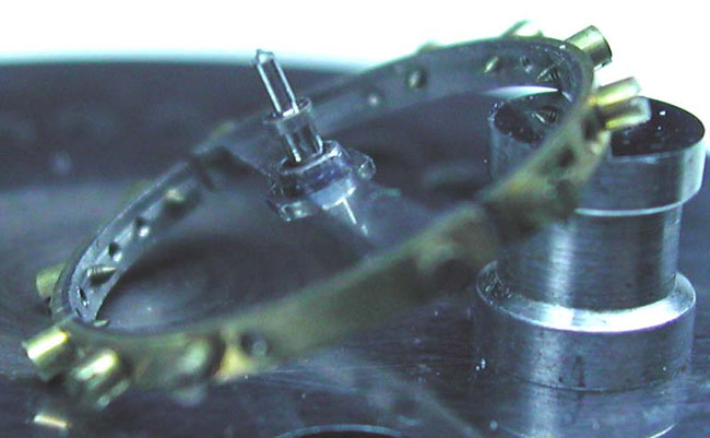

Waltham's friction staff was introduced solely for the benefit of the watchmaker. It probably required more production effort on the part of the factory because the friction staff requires a separate hub that is riveted to the balance wheel. Furthermore, the tolerances between the hub and the staff must be very close for the friction staff to fit well. The hub is made of blued steel so that it should be apparent to the watchmaker that something is different. Waltham also listed, in their material catalog, replacement hubs for the unwitting watchmaker who did not realize he was dealing with a friction staff and drove out or turned out the entire assembly. Attached is a poor photo of a staff partly out of the hub that you can see still attached to the balance wheel.
