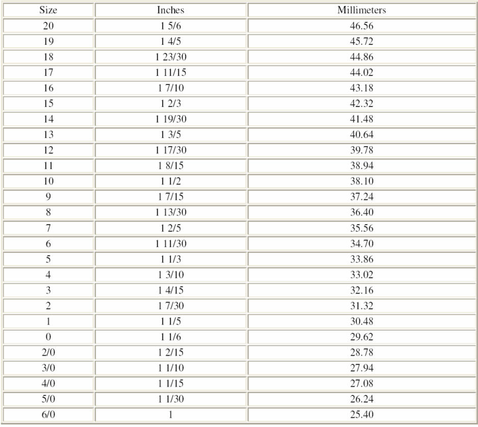

Below is a sizing chart that I came across several years ago. Yes, 27.94 millimeters is considered to be the equivalent of the American 3/0 size.
You may have stumbled onto an interesting correction of Wayne’s database. Although he does indicate that the database on his web site is perhaps one of the most complete to be found, he does not claim it to be infallible (to quote him “I have found a fair number of errors in Elgin's own serial number lists.”). If the Elgin records were compiled later than the mechanisms were produced then you may have stumbled onto a fault in the memory reconstruction of the records. The source records would have contained the disparity, not the transcription. Such an error would be almost impossible to detect and would be reveled only by having a number of 109/60 mechanisms in one collection to compare.
On the other hand, only the one record of that specific mechanism may be in error. There is only a 1.68 millimeter size difference between a 0 size mechanism and a 3/0 mechanism. That size difference could be optically ‘disguised’ by the movement’s case. So, you would need to measure all of your 109/60 mechanisms to determine if the error is confined to the record of that single timepiece, or if the general description of the 109/60 mechanism is possibly at fault.

I think you said you measured across the back of the movement. The size measurement is across the dial. The dial plate is larger than the back plate to facilitate putting the movement in the case. 2/30" is the amount required for a 0 size movement. The difference varies a bit with watch size.

2/30 would cetainly account for the size variance.
Tom;
Do you have a more extensive listing of the front plate versus back plate size differences that you could post? It would be a great aggravation saver.
