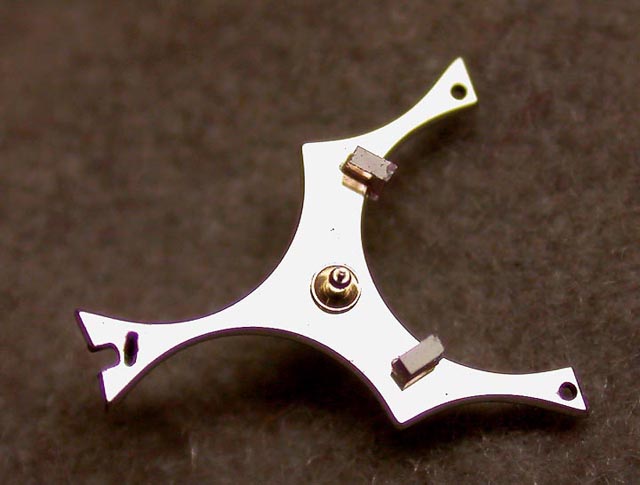

A few months ago there was quite a lenghty discussion on the DeLong escapements and the use of upright pallets, can anybody guess which watch used this pallet fork with upright pallets?
I'm getting better at taking extreme close-ups!

Steve MaddoxIt looks like something E. Howard would do, but that's really just a guess.
The pallet staff appears to be staked-in like a conventional balance staff, and while the pallets are upright, the stones (in operational cross section) are still conventionally shaped, and the escapement appears to be a standard lever.
The only advantage I can see is that by relocating the operating plane to a position above the pallet surface, the counterpoise can be made from the same flat piece of metal as the rest of the fork, rather than being a separate piece attached to the top or bottom. With this design, it's apparent that the counterpoise "horns" will operate beneath the escape wheel, which would not be possible with a standard arrangement.

Harold VisserSteve you are right, this pallet fork is from an early Howard #1428. Many of the first Howards up to about #1500? used the upright pallets.

Dr. Clint GellerHoward & Rice "Model 1857" movements, also finished by Howard, similarly had upright pallets.
