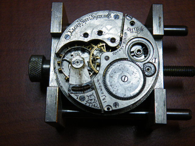

Bulent OgelElgin movement without serial #
God Morning,Good Sunday,
Why this movement has no serial number?
Thank you,
Bulent
December 05, 2010, 09:50
Tom BrownHave you looked under the bridge plates for any numbers?  I think the possibility exists that it could be two different models put together.
What size is the movement?
December 05, 2010, 10:11
Bulent OgelSize is 16S. Probably grade 152, class 35. On all similar models the serial number is on the train plate.
Under the train plate there is number 36502 stamped.
Bulent
December 05, 2010, 13:41
Tom BrownIs the same number stamped on the other parts & under the dial?
December 05, 2010, 13:48
Ray HallenbeckStrange indeed as it appears that the damaskeening is a match on both plates
December 05, 2010, 14:57
Bulent OgelMovment has no dial.
Number on the main plate is same.
Number on the barrel bridge is different.
Bulent
December 05, 2010, 15:15
Tom BrownBulent, I would have to guess then that the serial number of the original dial plate & train bridge was written on the original barrel bridge.
I have seen Illinois watches put together from different bridges so there is no exposed serial number.
December 05, 2010, 15:35
Jerry KingBulent, hey guy how're you doing....
I don't think it is a Grade 152....here are all the 152 movement serial numbers and none fit....with the last five digits being 36502....

Tom, if the barrel plate was used from another movement then that means that there were two that didn't have a serial number...
I agree with Ray in that the damaskeening does look like a match from plate to plate....

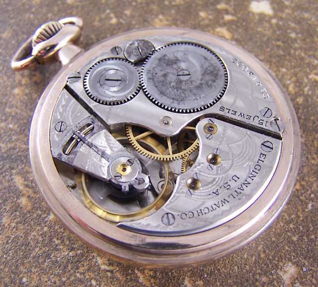

Jerry KingBulent, this one comes pretty close to looking like yours....and is a grade 313 and will fit in the serial number sequence....this is one of the 278 runs made of the 313:
17036001  17036001   2000      1912 313    16s o3n7p     15j e

Jerry KingBulent, on yours I notice that the USA is not under the "Elgin Nat'l Watch Co." like most are....I thought that to be odd also....
Let see what others think....

Bulent Ogel15 jewels
hunting
# under the barrel bridge 42527
Bulent
December 06, 2010, 07:07
Claude GriffithI think I have seen one or two posted examples on the net of watches that were missing the serial number or some of the markings.  In the case of Elgin making tens of millions watches dropping the ball on something would not be unbelievable. That fact that you don't see mistakes like this more often probably tells you their QC methods were decent.
 Also if you pop the dial you should see a symbol and a series of numbers, the numbers are part of the serial number.
December 06, 2010, 13:43
Jerry KingBulent, the No. 42527 does fall within the Grade 152 serial numbers....in the fifth to last run....
8042001 8042001 1000 1898 152 16s h3n6p 15j e
