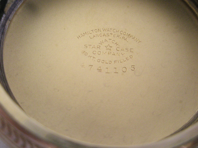

So I have this Hamilton case with S/N 4741105
all # are same on case is this case correct for 992b
movement?
March 15, 2012, 16:25
Peter Kaszubski
inside view

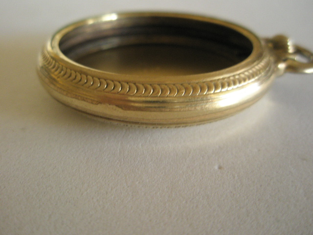

Peter Kaszubski
side view
March 15, 2012, 16:54
Edward L. Parsons, Jr.
That's a variant of the gold-filled version of the Hamilton Case Model No. 12 (pendant shoulders).
It's an uncommon case and would be correct for a 992B circa 1942-1948. It would make a nice combination with a Signature Type 2 992B, which is what I have in my example.
The more common version of the Case 12 is base metal (chrome-plated brass), which I have never seen with pendant shoulders.
IMHO that movement would be fine in your case 12.
