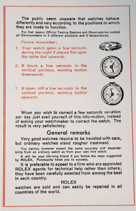

I just recently had a 992 (#2550837) serviced (cleaned, oiled and adjusted) by a local watchmaker who did a real good job, in my opinion. The watch was running and keeping good time within a minute or two of the U S Naval Observatory official time before I had it serviced, which I didn't think was all that bad for a mechanical watch from 1930.I would carry the watch during the day and at night I would place it horizontal on the nightstand with the dial up. After I got it from being serviced I checked it against the observatory official clock and it was about +20 seconds. Not a bad improvement. Then I thought to change the position of the watch at night to see if it would affect the accuracy any. So I went to placing the watch with the "3" up vertically on a little plastic watch stand and here are the results: after night 1 there was a change of -2 seconds ( +20 sec down to +18), after night 2 there was a change of -5 sec ( +18 sec down to +13), after 3 nights there was a change of -9 sec ( +13 sec down to +4 ). During each day I would wear the watch as usual. I have read from a book about Rolex watches that the position of a mechanical watch can affect the accuracy of it and here is the proof. I know that comparing a mech. watch-and from 1930 at that- to the atomic clock at the Observatory is perhaps asking too much but I am pretty pleased to have a 992 only +4 seconds off.
August 06, 2010, 09:47
Joe W. Campbell
here is the reference from Rolex
