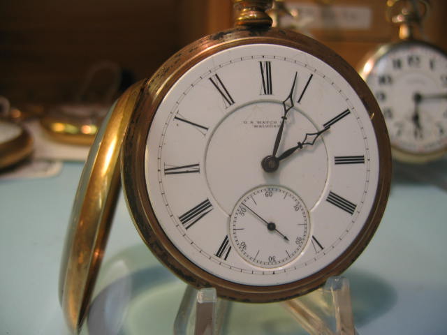

I got a movement that the seller suspected of being a 16t size, "swiss fake". It came, and I fitted some hands to the perfect dial, and found that it only fits in an old 18s case!

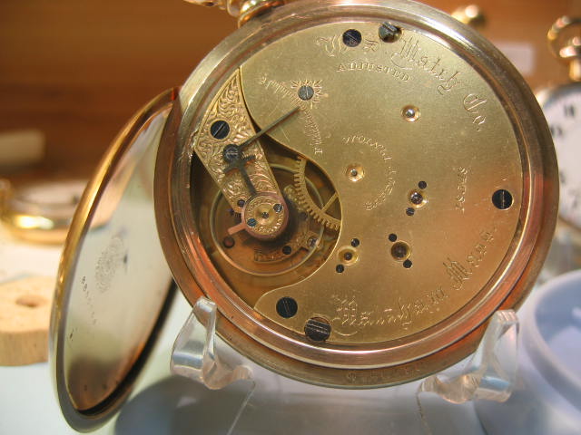

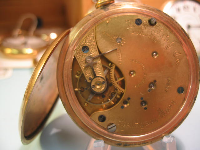

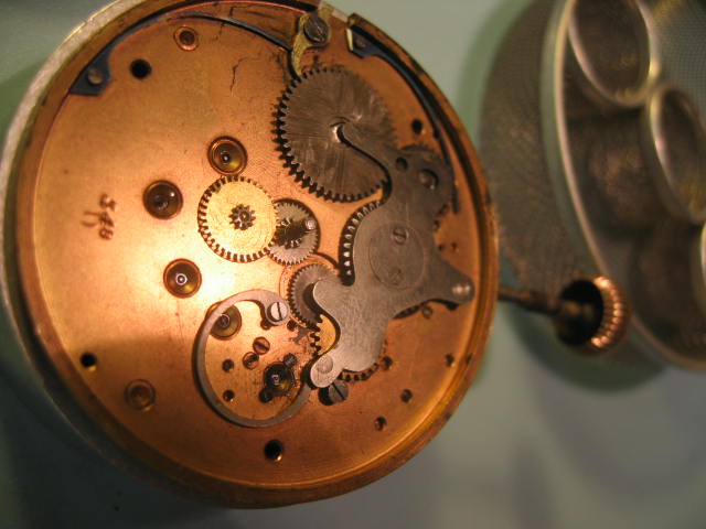

and it is an 18s US Watch of Waltham Movement, usually associated with the design they also made in 16 size. I have yet to research USWofW for this serial number 18348 but expect that not too many of these were made in 1889, their 2nd year of business. Now to exhume all the fossilized fishbrain oil and restore it. Neat way the stem comes out, little reversing slip screw, the one with all the arrows pointing at it. You screw it in and it locks the wind and set wheel so you can unscrew the stem and crown assembly and remove the movement. Took a little fiddling to figure that one out. Razz

A great example is on page 412 of "The Book" looks like the 16s on the right, but an 18s 3/4 plate like the one on the left. Says it's in both sizes too! What is that strange bar type part?

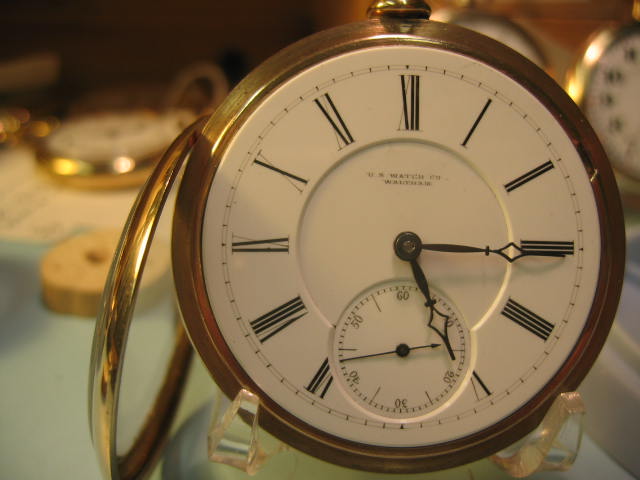

Well, I have to say this, I cleaned and reassemblde this guy, and must comment that this design is a totally unique stem wind stem set system. The mechanism sort of reminds me of those old "dippin beak" bird toys that you could mail order from scientific toy places . .
June 01, 2008, 20:38
Second, it runs in all positions even with the bottom staff pivot busted off ("my bad" Frown). . .
June 01, 2008, 20:41
So I have a real "purdy" 15 Jewel Adjusted 18s U.S.Watch of Waltham 3/4 plate 1889 (3 years b4 AWWCo.) that I will hope to do the final "fix" when I get home from ALASKA!
